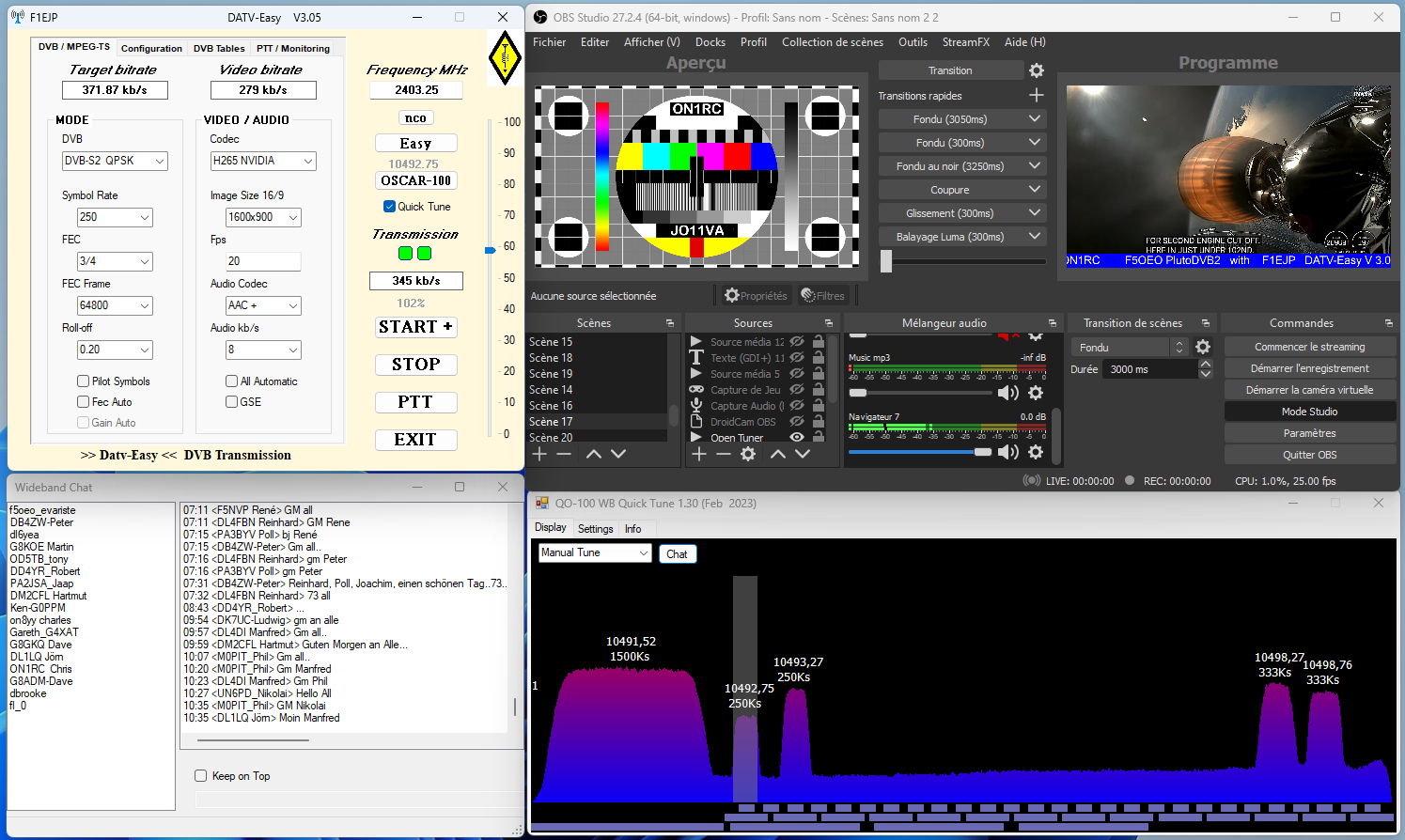

Exemple of use with Quick Tune integrated to DATV-Easy for change frequency and SR (in live with last firmware PlutoDVB2 F5OEO) ;)
