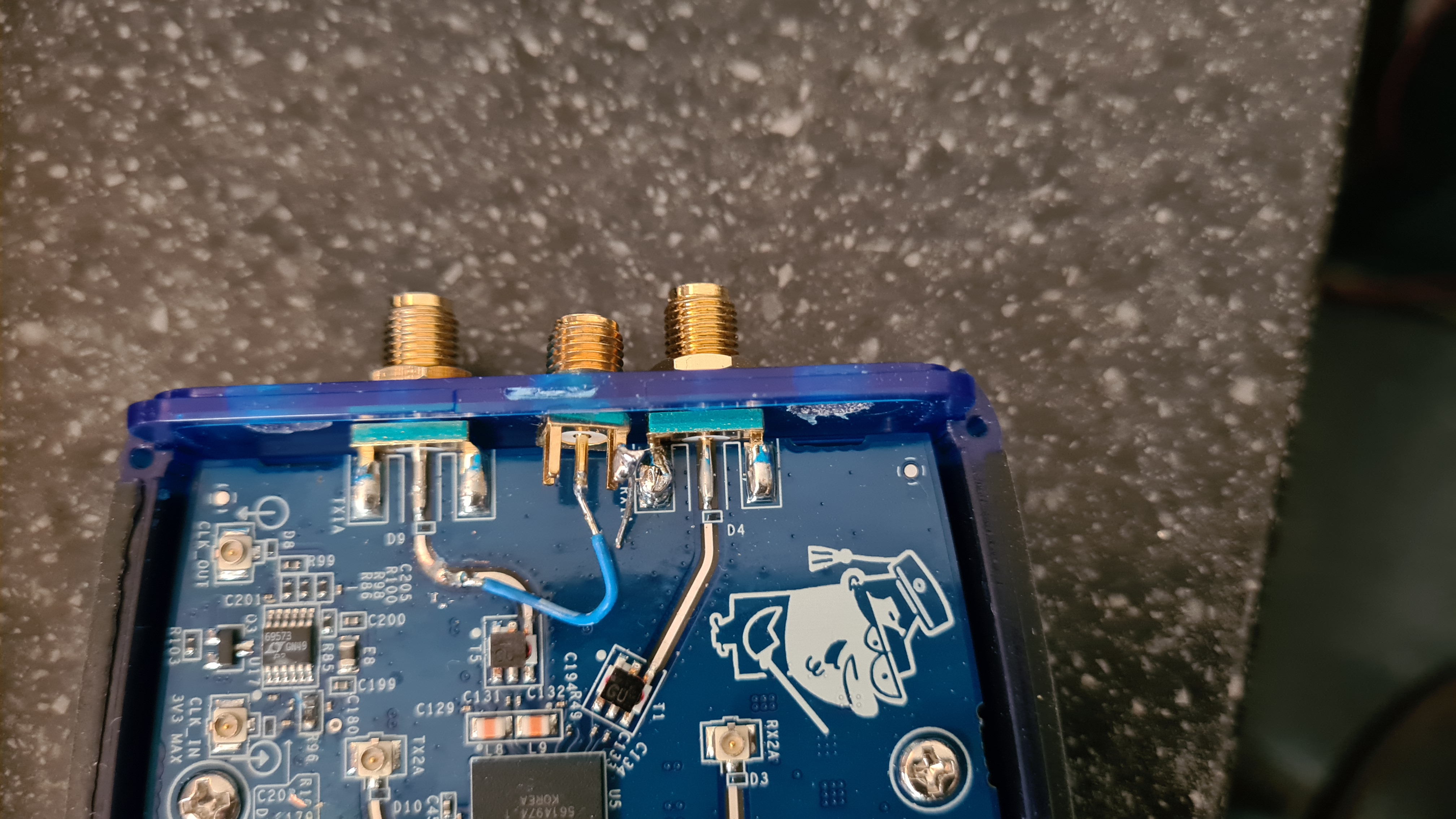

Further investigation (by cutting the track between the output socket and D9) showed that D9 was short circuit! So I have wired between T5 and the output socket directly with a piece of wire by-passing D9. The output is still low but usable with the cheap Chinese amplifier.
To others with low output. It is very difficult to fault find as the transformer T5 is a DC short to earth. Cutting the track as I did and measuring across the output socket might show if the diode is blown.
T5 may still be a problem but I don't want to push my luck soldering a new one in.
