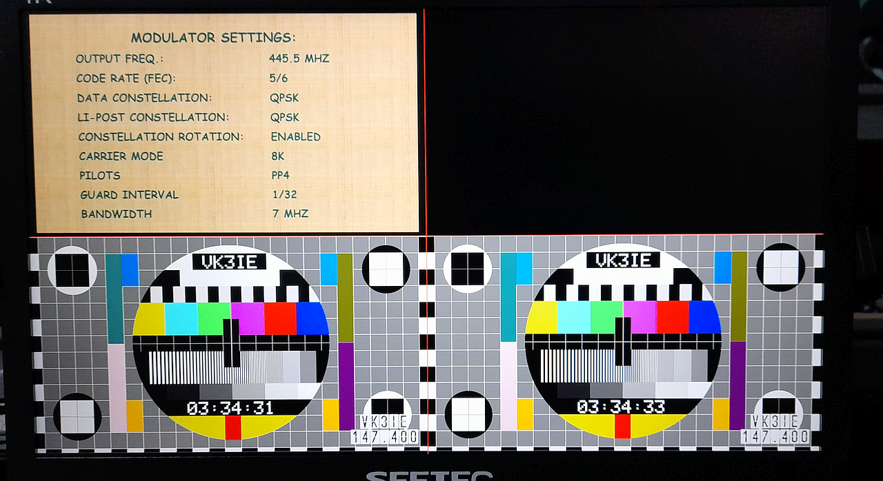

Alain
Looking good, quick Phone snap ;)
Robert

Hello Bob
I have just read your private message
The black and white squares in the top line are drawned on my monitor.
It is not a software issue but a monitor issue or hdmi to transmitter issue.
In line 236 I correct the line with the variable call instead of the string "F1CJN".
You can download the test card software on GITHUB/F1CJN
