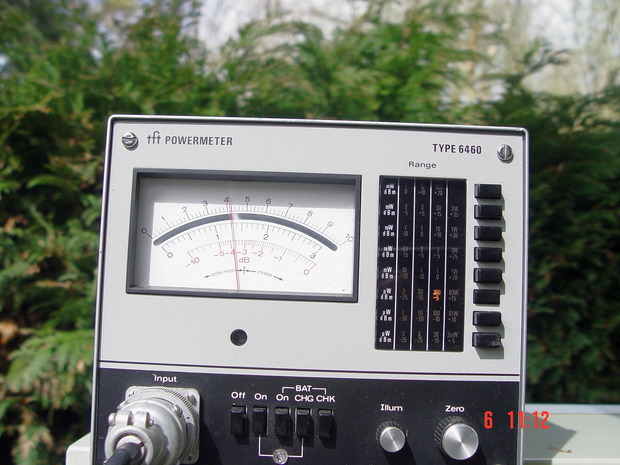

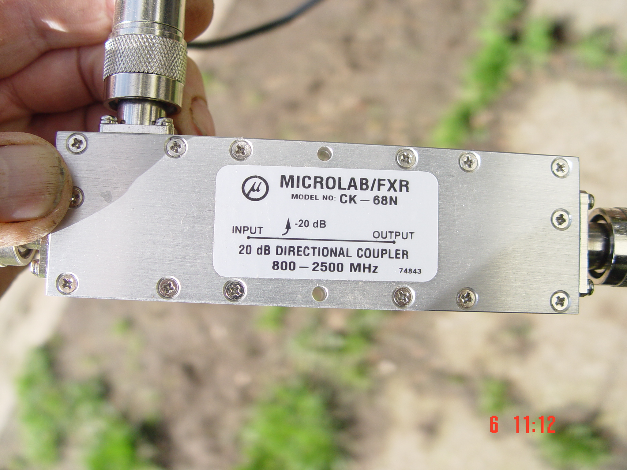

I bought a cheap Chinese 40dB directional coupler, that on unpacking rattled. I took the lid off to find an appalling build quality and the thing shattered in pieces. So I bit the bullet and paid £80 for a branded one with a full spec sheet. I can now use a Marconi 6460 meter and power head I bought at a rally years ago to test power to the POTY. A friend heavily into microwaves with a lab full of calibrated gear checked it was in spec and surprisingly it was bob on!
So today I put the meter at the dish, added (for peace of mind, I know how fragile power heads are) another 30dB of attenuation in line with the new 20dB coupler, for a total of 50dB attenuation, and increased my signal up to the overload level, then a tad down to a fraction under it. It looks like 13.2W is all I need into this big dish. Which correlates with how much drive I have to give the 20W SG Labs amp.
So I now have some references to calibrate a digital setup.
