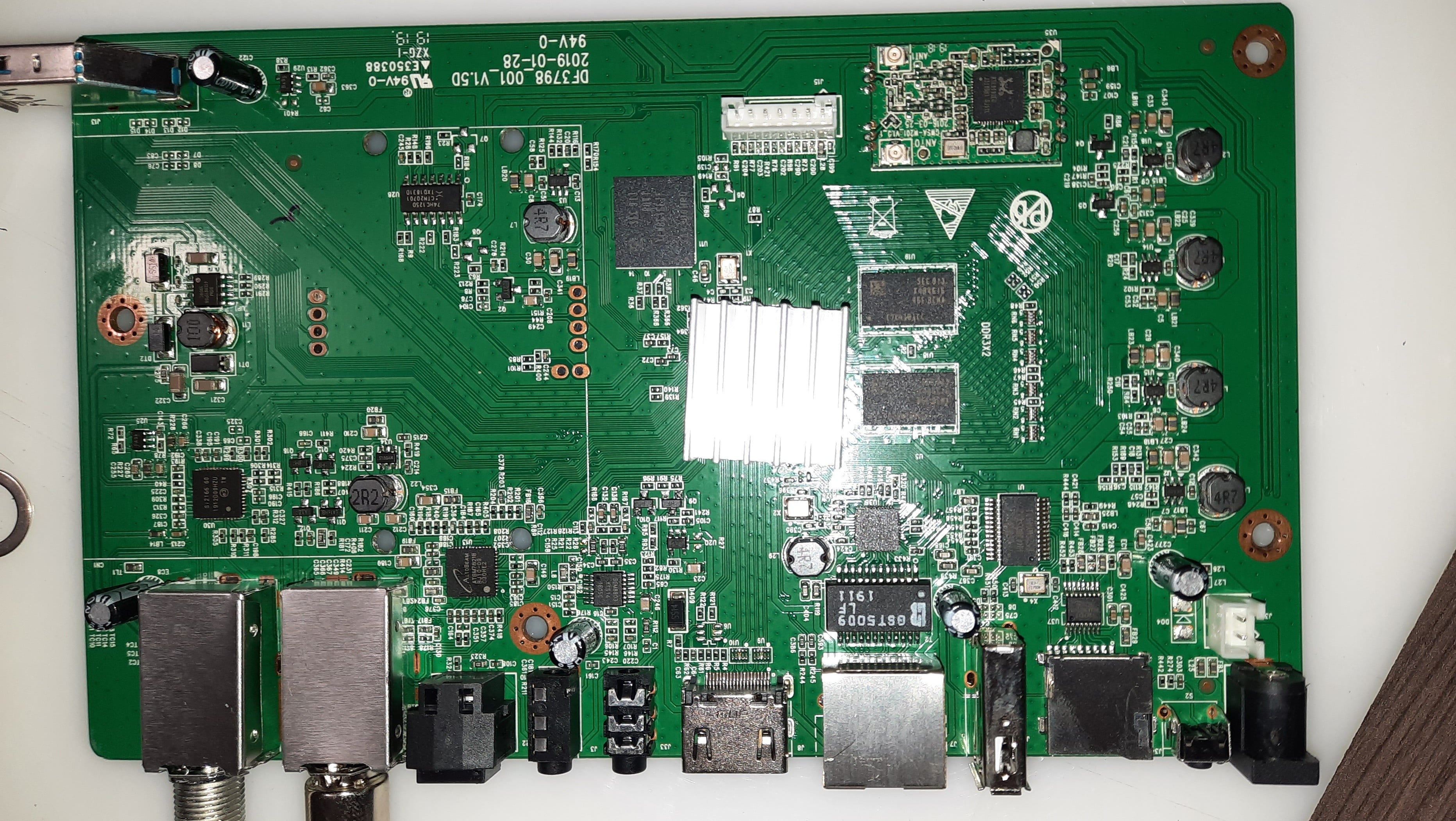

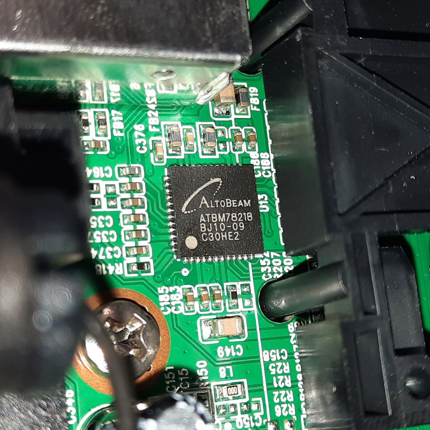

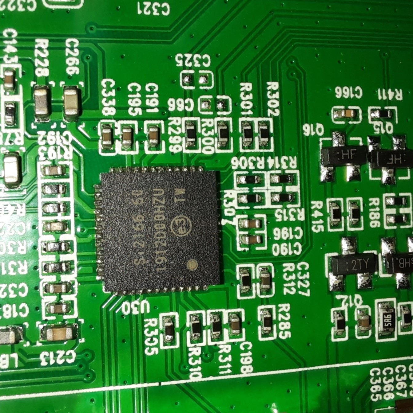

Hi Dave,
The DVB-S tuner is a Si2166. For information, the tuner DVB-T is a AltoBeam ATBM7821B... Stephane

Thanks Stephane
How well does it work on QO-100?
We'll be needing the long-form datasheet for that chip if we are going to make progress. The short data sheet is here: https://www.skyworksinc.com/-/media/Sky ... -short.pdf

The superset source code of the silabs you can find here:G8GKQ wrote: ↑Thu Jan 05, 2023 9:11 pmThanks Stephane
https://github.com/swks-mss/video_si21xx_superset
There are ways to use directly or via fx2 usb-interface..
Cheap NIMs with si2166 demod you can find on "plugins-tuners" for gigablue,octagon,AX etc. receivers
For example ,TS3L10...NIM pinout is known(using ssi)...but for pcb you have to find out pins
https://store.gigablue.de/zubehoer/tune ... r-v.2.html
