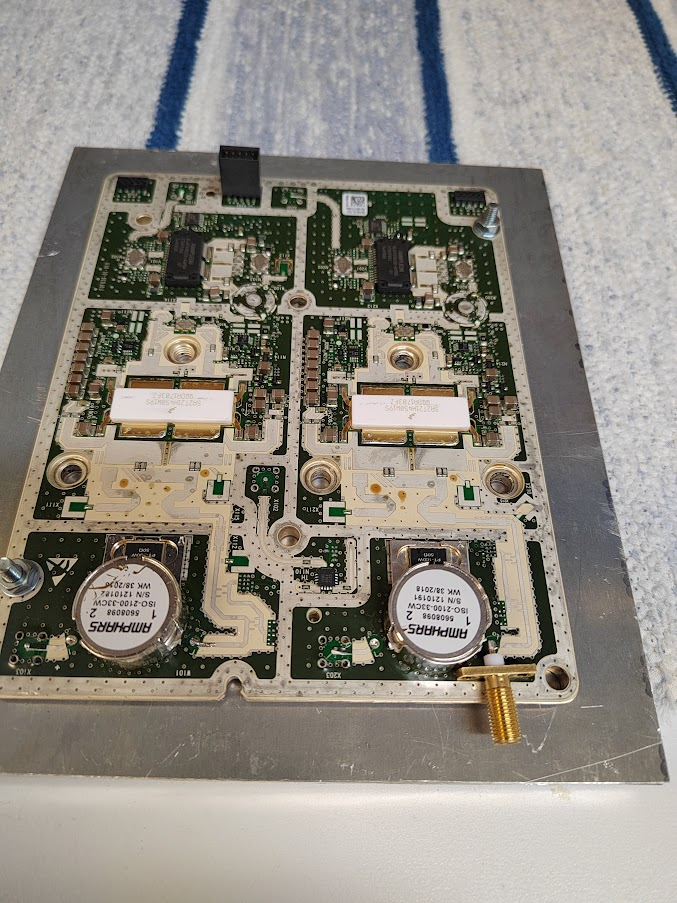

Another picture
2.4 PA in ebay
Re: 2.4 PA in ebay
- 20230226_162849.jpg (1.18 MiB) Viewed 3944 times

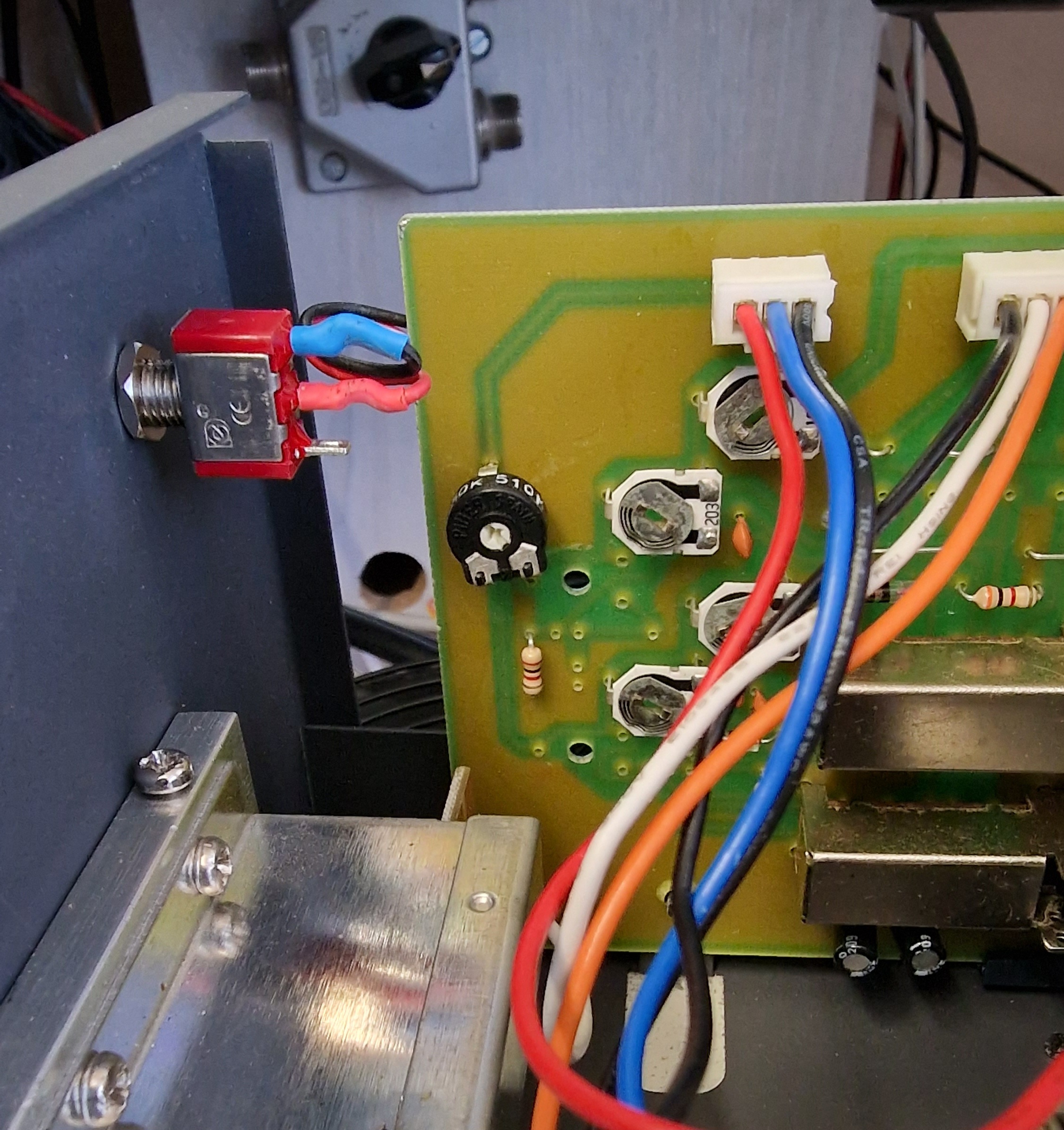

Thanks Brian
That's clear pot across the link and a switch to short it out.

Hello
I have been able to do some work.
I was able to take out smaller parts, but big ones did not give out
Would it be OK to keep these and just solder connector ?
Another question from PTT
-Should i do it only by 28V enable or also controlling PreamplIfier power ?
Picture enclosed
Br. Esko P
