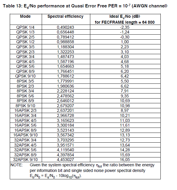

Is there a calculator to calculate the minimum required C/N for certain DVB parameters?

I don't know exactly how it's calculated, but here's a list.

Looks like this list is for DVB-S2. Also a list available for DVB-S?

The values for DVB-S are approximately:
FEC 1/2: 1.7dB
FEC 2/3: 3.3dB
FEC 3/4: 4.2dB
FEC 5/6: 5.1dB
FEC 6/7: 5.5dB
FEC 7/8: 5.8dB
