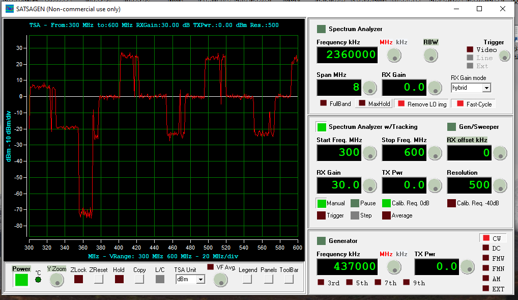

I was doing some testing today to see what power I was getting on 13cms last Sunday, but I wasn't getting any RF. The Pluto was also disconnecting itself from my PD4, needing repeated re-starts.
Strange, I thought, so I put it on my PC and loaded Satsagen up, (very reliable software). On running the calibration routine I got really strange waveforms coming out/in - see attached. So I tried re-flashing it with the recommended 'for the brave' firmware (what was already in it). That went OK and it rebooted fine, but still with the problem.
I can but assume something dire has happened to its internals. A shame as so far my 3 have all been very well behaved (other than the USB/ground/earth loop sensitivity).

Resolved thanks to Noel G8GTZ who suggested I try a 'Full Monty' DFU re-set. And it works again, a great relief as they are now £220 to buy.
