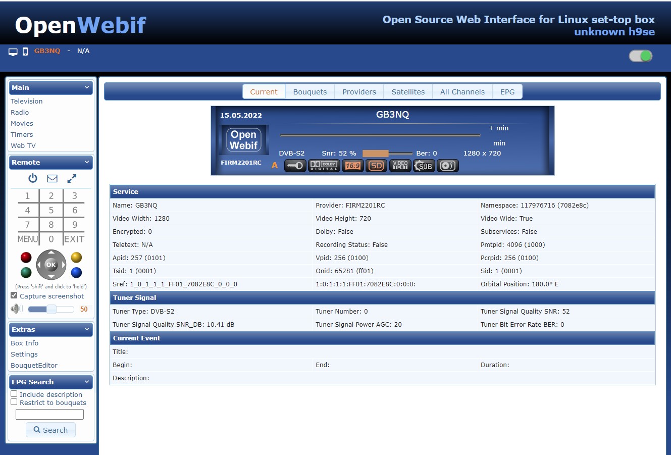

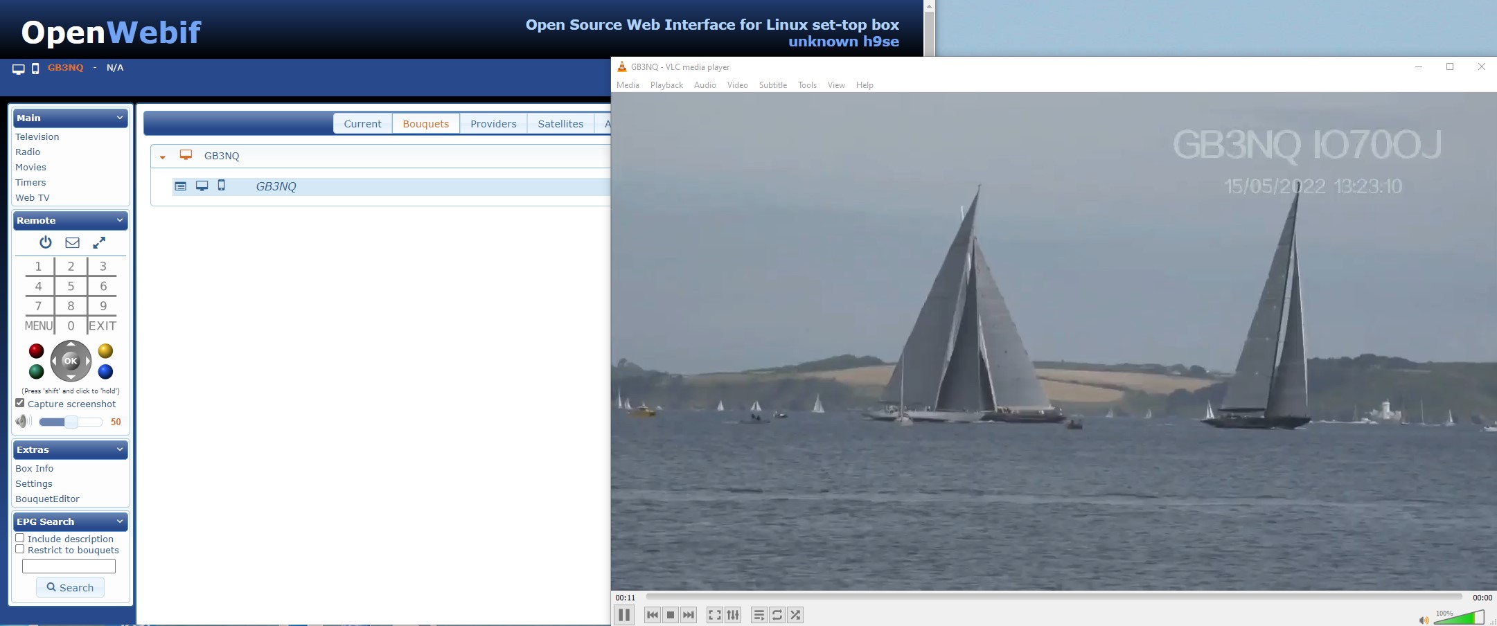

I have updated the firmware on on of the boxes using OpenPLi. This was found via searching for information on the web. It was quite easy to do. The hardest thing was to tune in the local repeater that I wanted to receive. It probably is also quite easy with the right instructions but the manual mode to tuning is the place to start.
Once working with the device on the local LAN you can control it from a webpage and also view the reception via VLC. The setup can be backed up into a loadable file so if you had someone with one working receiving something you wanted, then you could use their file to setup your device.
It could be possible to set one up to receive several selectable channels/frequencies with various SR etc.
Here are some screenshots of the remote setup on my Windows computer.
