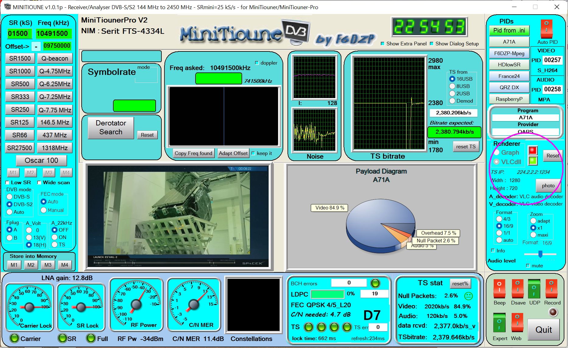

Thx Again Nick for reply I decided today to put up the 80cm dish for SSB narrowband RX and is lined up fine. I use the 100cm dish for DATV RX and the ice cone potty for TX only problem on both Narrow and wideband as the Junction Box with tx about 1m of cable used for tx low loss,Problem now is and I dont Know why but I run minitiouner and get all green light on the video beacon the c/n mer is 7.5dB and D4 and it isnt receiving have moved the skew and still the same with Video at 87% Overhead 4.5% Null Packets 3.2% and Audio 5.2% .

If you have all green lights and the transport stream is being received it is more likely to be a problem with the video codecs if the transport stream statistics are updating OK. I assume you tried the render with VLC option.
When you ran the test application as per instructions what did you get? If you record the TS can you play it back in VLC?

thanks for all your help everyone, last night i received ok and managed to see video so now I have ordered the 1.1m dish as the 1.2 is only fibreglass version and very expensive so should be better if not will upgrade again but its getting an eyesore for neighbours if it gets bigger. It has arrived but high winds next few days so will do when weather better. After that may need help on the tx side of things thx all for helping me would be lost without the help much appreciated.
