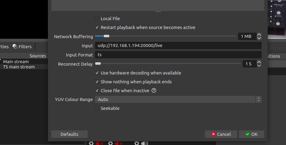

So to OBS you will need to add a media source into a scene.
add media source and change the parameters similar to what I use here. You will enter your broadcast address of udp://232.0.0.11:10000 and not as above. ensure you select ts as the input format and try the other tick boxes as I have them. when you click OK it should add a windowed area to the preview screen, if you do not see anything then try this. Highlight the media source bar, right-click to bring up the sub menu, go to Transform which will bring it's own menu up and click on fit to screen. Sometimes the window is hidden and this makes it visible in the window.

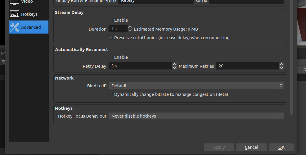

If it works, congrats, there are also a few other things I have changed within advanced settings: - OBS studio I think is meant for online streaming and will tryo to reconnect to it iif it looses the stream as such it holds the connection open so the extra tick boxes allow this to be turned off, this helps when one is switching from one stream to another with a break in the middle.

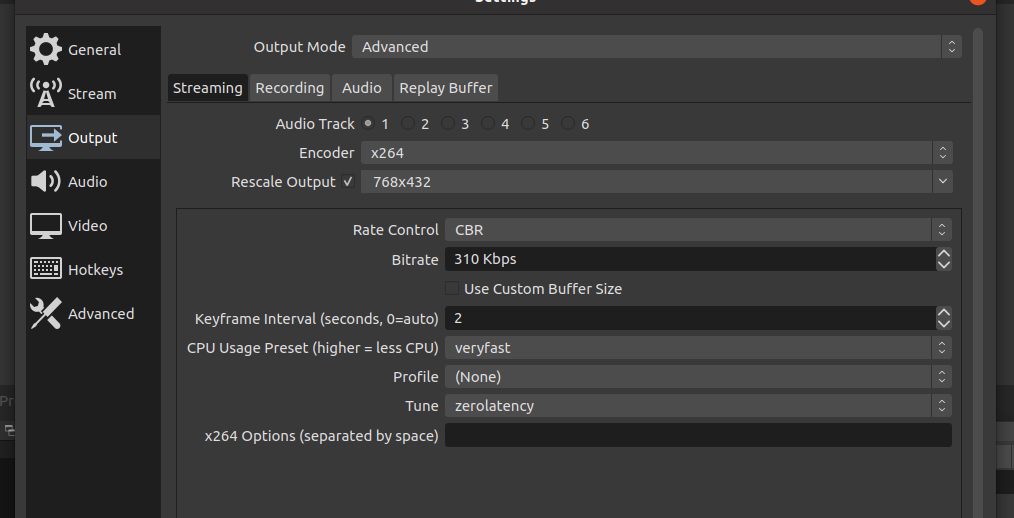

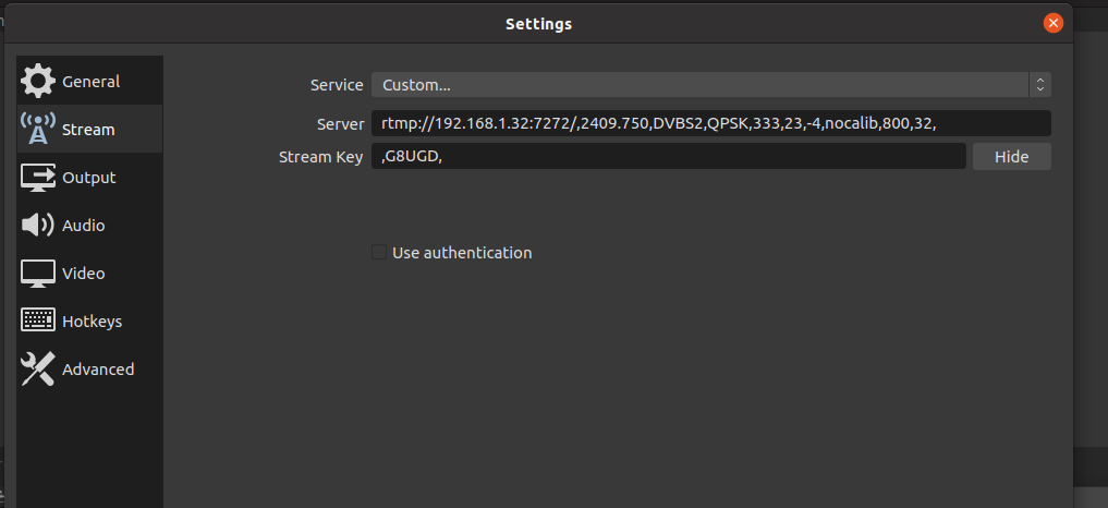

Just done a simple setup on my PC and here are two pages of settings I have in OBS I have the frequency up at 2409.750 but would be otherwise the same for 437 MHz the other main difference is I have my pluto on 192.168.1.32 as it is not connected via usb.
