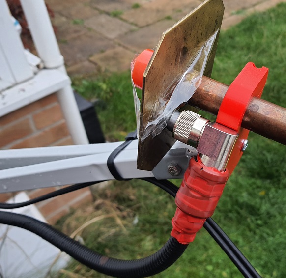

In my case, I currently have FSJ4-50 with surplus right-angle N types on both ends. I used an N connector
on the amp (~50W) and also on the back of the POTY so there are no transitions.
I had to print a replacement feed clamp with a slight cut-out to allow the right-angle connector to fit.
I'm still unhappy with the loss in this arrangement so am looking to move the amp into a small
weatherproof box under the dish to reduce feeder length and possibly replace feeder.

The problem with connecting the coax directly to the patch is the rigidity of the stuff. Dealing with differential expansion with temperature, wind flexing etc. Possible I am sure with care. I like that connector arrangement, you might even be able to use the coax as the feed support. I hope you are going to weatherproof it properly. Water has the ability to seep into everywhere and spoil everything. I have a 20m length of LDF4-50 with 3 dB loss on 70cm to prove it.

Post by g7ocd » Sat Nov 28, 2020 4:29 pm
Yes, there is an overall radome which was removed to take the photo :)
