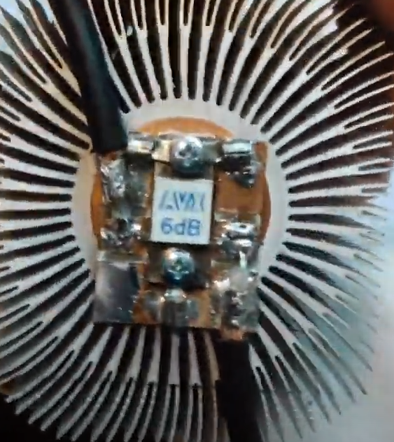

Developing the theme I saw this idea on a Russian MRF300 amp video (144MHz in this case). I did something similar a while back with a 50R thick film resistor on a PC heatsink, with a BNC mounted directly above the socket and it works well.
My question is, is the termination method shown better that a short wire to a BNC in and out socket mounted a few cms away?
I'd guess that as short a lead-in as possible is the best and by using some HD solder tags under the attenuator fixing screws, I can get down to negligible lead lengths using coax flying leads with the braid solder-flooded and secured by the solder tags.
Shorter is better.....?
