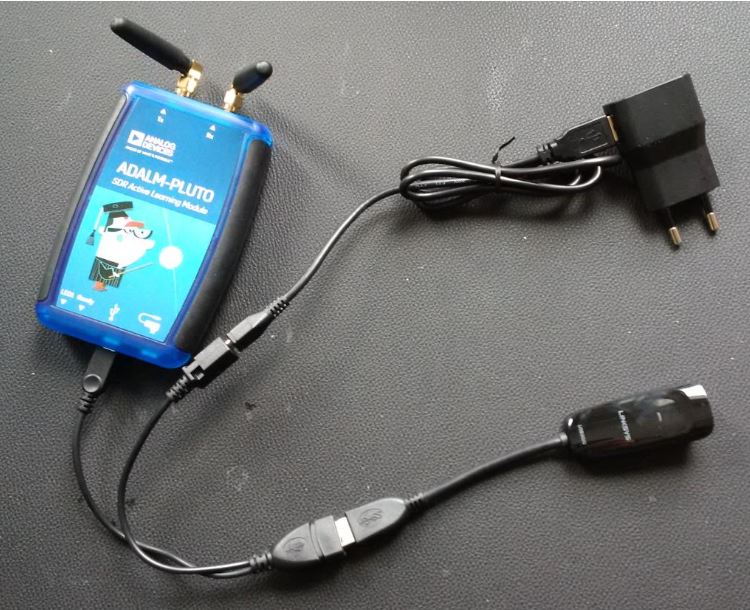

Another thing I have found while using my Pluto is that the USB disconnect when there is a problem with earth voltage differences is a lot less if the Pluto is powered through the power micro USB rather than an adapter as in
So I would not power it like this but straight into the Pluto via the socket on the bottom right when connecting it to a linear amplifier.
