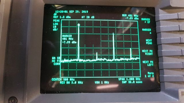

Initially I chose -1 dBm output power. 50Ohms setting and No PAD in use. This resulted in the following trace:-
-1 dBm came out as -7 dBm. I didn't fancy mixing those harmonics either.

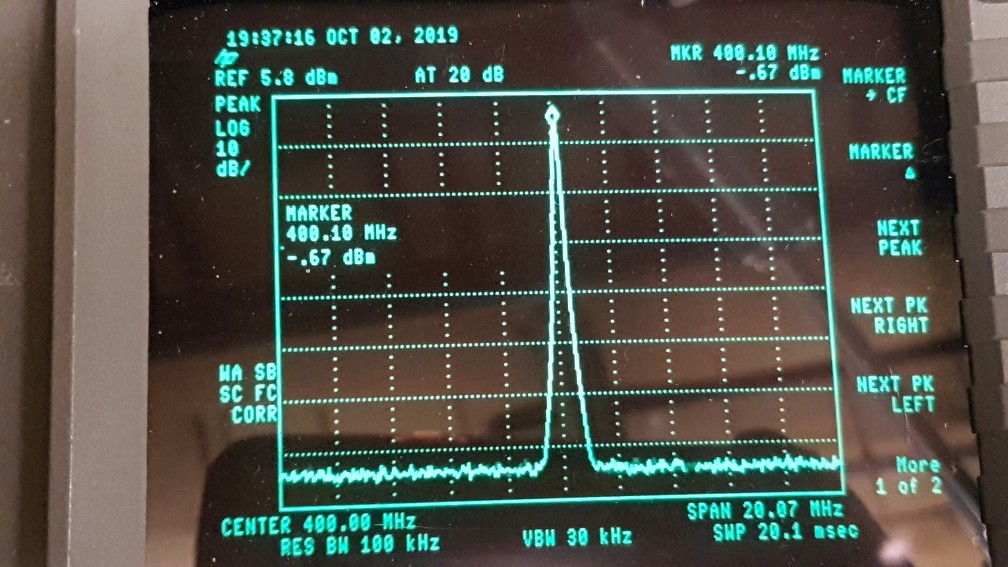

I reprogrammed the PIC for +5dBm - its highest value which gave the following result:-
Minus 0.5 to 0.7 dBm.
For the upconverter circuit do I put a 0R resistor/link in for the input attenuation?
Will the upconverter work ? What did other constructors do with this project?

The mixer wants 7 dBm but it will work with less, with less initially you lose dynamic range, then the conversion losses increases until it does not work at all. The opposite with higher power, until the diodes expire. I would think 5 dBm will be fine. You could add an amplifier and an attenuator to get 7dBm but it's not likely to be worth it with 5 dBm. Looking at your unit 5 dBm is not met so a bit of gain may be needed.
Here is the official advice: See the Graph on page 6 and comments on LO drive. It looks like performance of this mixer will start to drop quickly below 4 dBm drive. With 5 dBm the loss is minimal, though it won't handle strong signals quite as well.

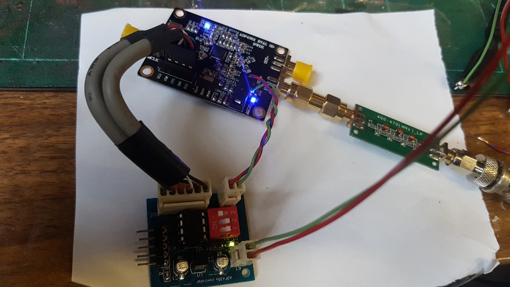

I put together the chain of modules pictured.

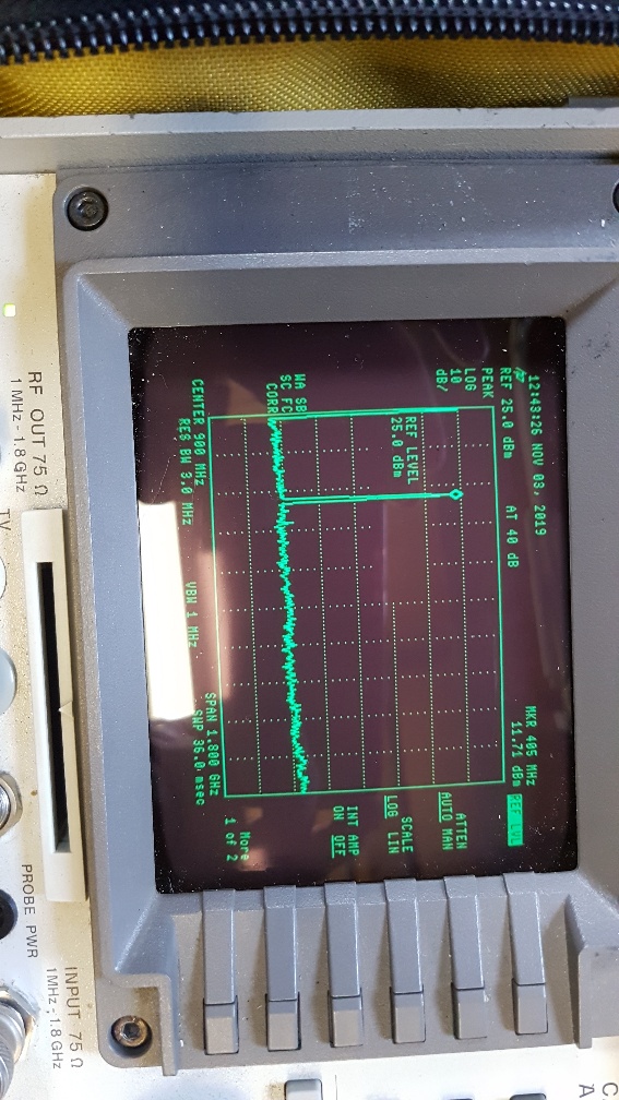

The code asks for 400 MHz at 5dBm. [Analyser levels in brackets].
The ADF4351 outputs today 405MHz and -1.6dBm [Analyser 0 dBm ref at 10dB].
Adding an amp gives 21.4dBm [25dBm ref at 40dB]
Adding 9dB attenuation gives 12.2 dB [same as before]
Adding an EBay low pass filter gives 11.75dBm pictured.
The upconverter has a 6dB attenuation fitted.
Have I understood my analyser correctly i.e. auto attenuation selected and the displayed powers are true? I hope I'm going about this ok. I'll bring the upconverter and LO units to CAT 19 South for the clinic and a tutorial.
David

Hi David
All looks sensible to me, although the ADF4351 should be on 400.000 MHz if programmed correctly. Analyser frequency calibration? You could take a look with an RTL-SDR and SDR Sharp.

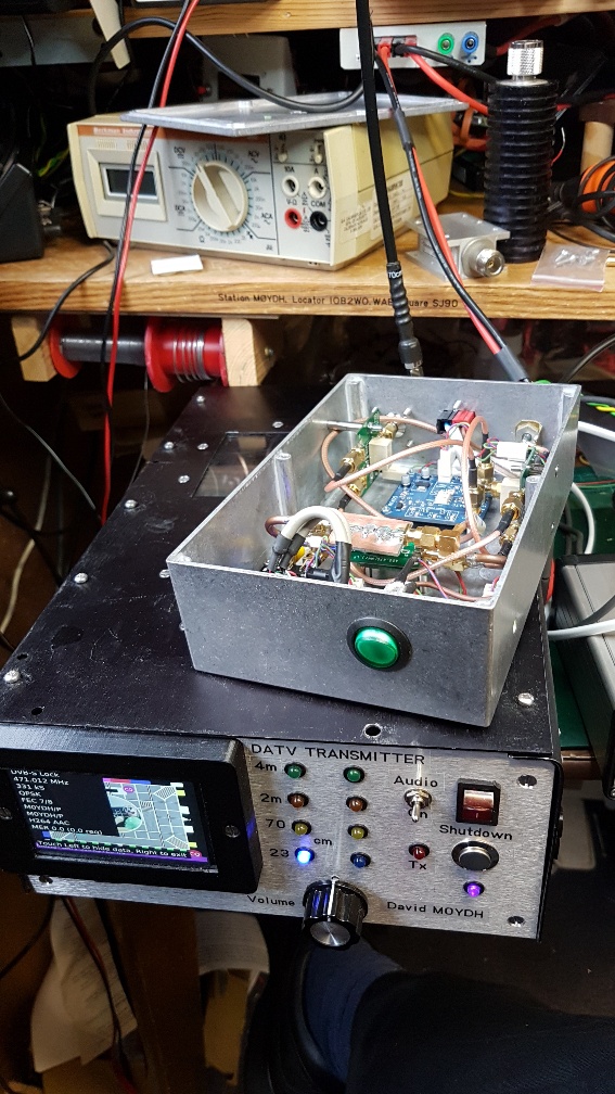

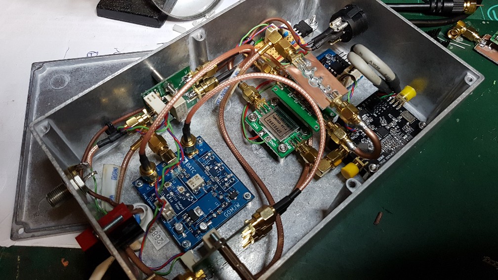

Thank you very much for the test and set up Dave at CAT19 South.
I finished the project and used a pair of Mini-kits coax relays to give bypass or up conversion control.
It worked first time.
Also works fine with Minitioune .
My video of the new kit in action is https://youtu.be/D9r-Zb_YhsU
David M0YDH
