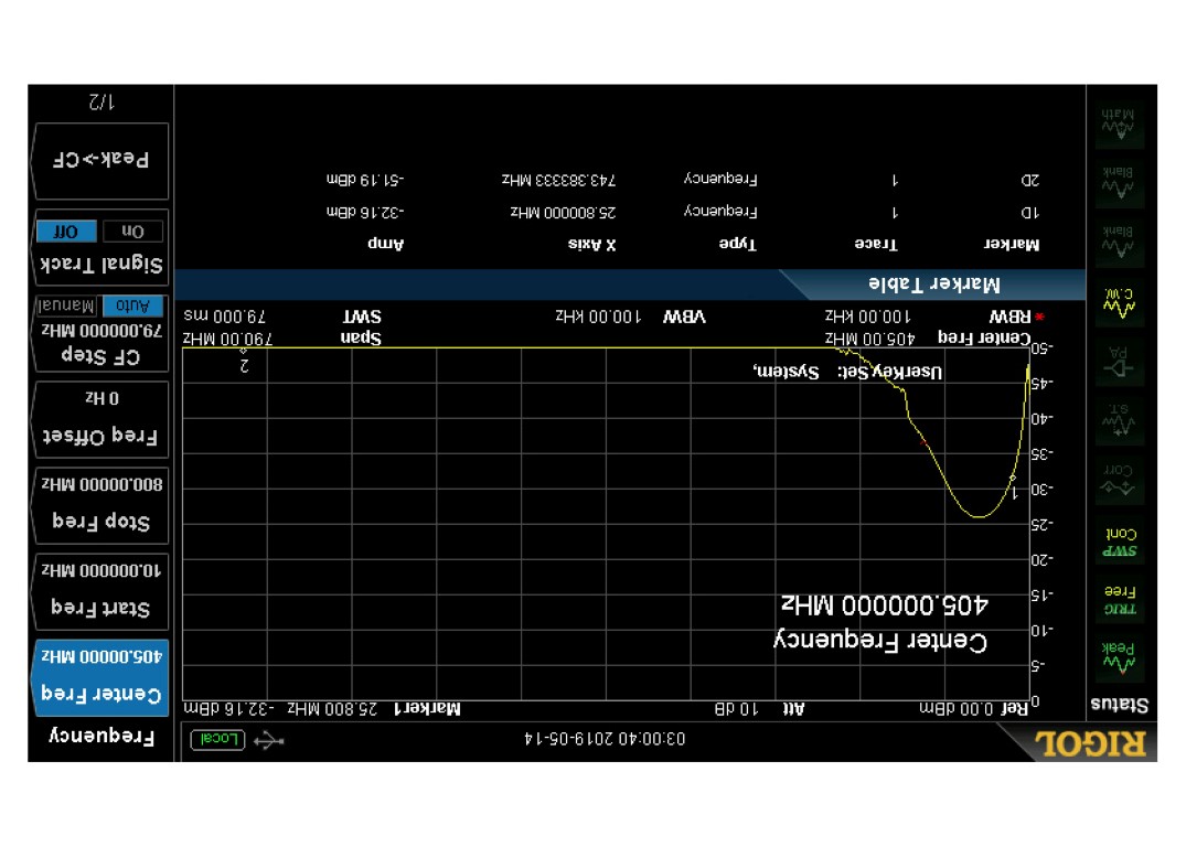

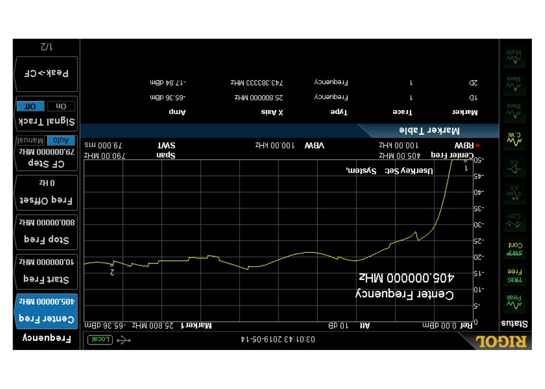

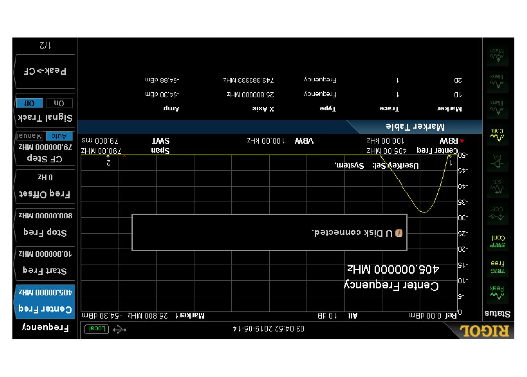

I have build BATC Bias-T and reference Injector PCB, but the filtering isn't good between LNB input and the Reference input.
I have added some screens from my analyser.
I have build the PCB with the 2 optional attenuators.
I don't know why but I have rotated the pictures again and again but they still upsite down on the forum ( sorry )

I can't really read these upside down- can you explain what you mean and what you were expecting from a simple diplexer? Anything over 20dB at 25MHz vs 789 MHz is a bonus.
