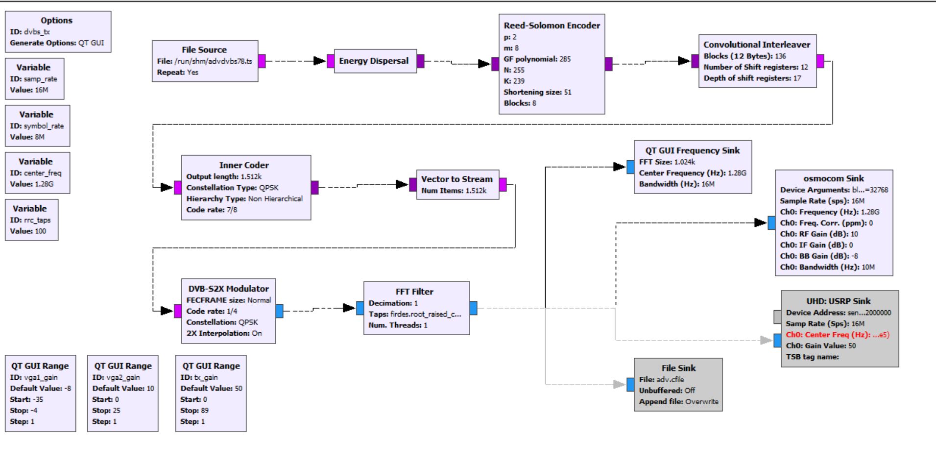

Post by G8AGN » Sat Jan 26, 2019 8:21 am
Hiro
Please can you post a larger picture of the GNU flow chart for the Pluto DATV? The slide in your presentation is too small to read.

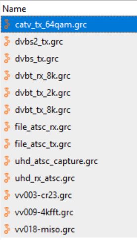

Post by g0mjw » Sat Jan 26, 2019 8:58 am
Hiro
Barry G8AGN
Hi Barry,
Did you look at the examples? e.g.
There are lots of them in the examples directory under dvb
