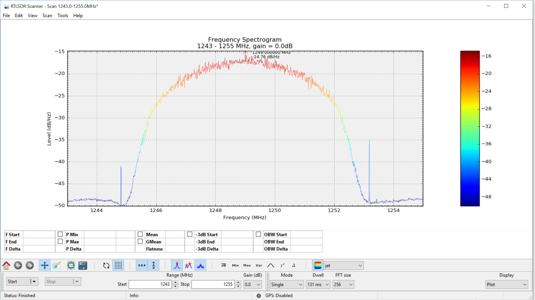

You might also look at SDR Console and a host of other packages.
A problem is that the bandwidth is only up to about 3.2MHz. This is fine for RBTV but clearly not for 4MS - fear not though as amateurs have developed scanning software. Have a look at RTL-SDR.COM e.g.the post on https://www.rtl-sdr.com/rtlsdr-scanner- ... -released/ You can do your own with gnuradio but maybe that's a bit too advanced.
