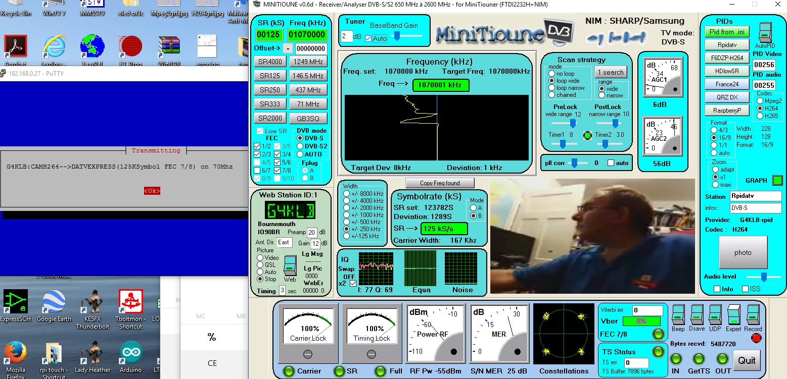

The DATV Express is specified to work down to 100 MHz, but I read somewhere that it may work as low as 50 MHz.
Tests tonight proved that it is excellent on 70 MHz, but I've not had it working on 6M so far. Maybe the problem is with my up converter, so posting this to ask if anyone else has tried it.

Sorry to disappoint you Colin but the lowest it will do is around 65 MHz
this is limited by the internal VCO and the size of the divider chain in the PLL.
LimeSDR (see other thread) will do 50 MHz and 3.4 GHz out of the box and they
(Lime) have plans for an extender board that will also add 5.8 Ghz and 10 Ghz.

That confirms what I found, 65MHz was as low as I had it working last night, but now I know why.
The comment ' The DATV Express board will also go to 50 MHz' I read here http://www.batc.org.uk/forum/viewtopic.php?t=3952
Got me over excited :D
