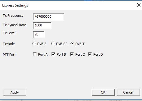

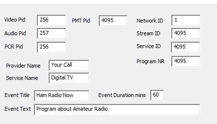

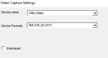

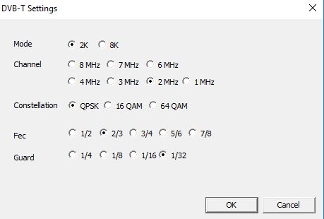

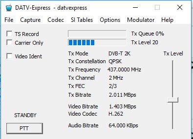

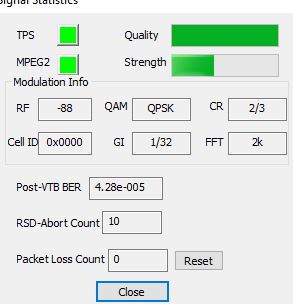

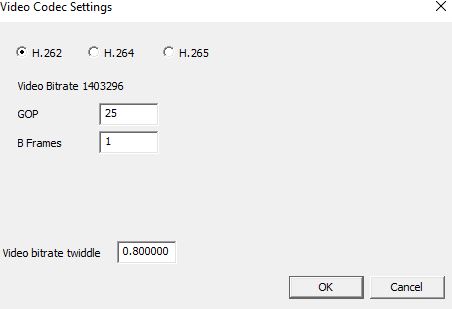

I'm running DATV Express V1.23 on Win 10; video source is vMix. Receiver is a Hides UT-100D with BDA Viewer+
Pictures below of what works and what BDAViewer+ reports:
Hope that helps
Hope that helps
- RX.JPG (22.91 KiB) Viewed 10795 times
- Mod_DVB-T.JPG (21.08 KiB) Viewed 10795 times
- Mod_Common.JPG (21.96 KiB) Viewed 10795 times
- Codec.JPG (17.77 KiB) Viewed 10795 times
- Vid_Capture.JPG (15.12 KiB) Viewed 10795 times
- Main.JPG (30.93 KiB) Viewed 10795 times

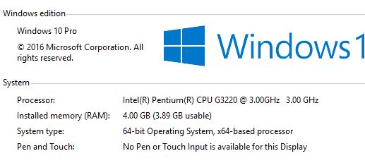

Can you make screenshot of your SI Table please ?
Re: DATV Express : Help needed :-)
HI
Here's the SI Table and the system tab
- System.JPG (29.86 KiB) Viewed 10789 times
- SI Tables.JPG (24.55 KiB) Viewed 10789 times
BTW, TX and RX running on the same PC.

On DATV-Express for Windows, the DVB-T protocol USB-traffic has a tendency to “overload” the computer USB-bus-architecture on a slower PC and can even “overload” some newer PC’s that have a poor USB-bus-architecture design. The DVB-T USB-loading is very close to the real-world throughput limits of a USB-2 bus. Charles G4GUO who has performed much DVB-T testing with DATV-Express explains that if the DVB-T USB-traffic to the DATV-Express board can not keep up with the protocol bit-rate/symbol-rate, it creates short drop-outs in the transmission that can upset some DVB-T receivers. In the referenced posting of the 2016-12-01 “DATV-Express report”, Charles reported that “Only one of his three 64-bit computers running express_DVB_Transmitter [Windows] software would allow the UT-100B to lock on his signal.
Also, running vMix on the Windows increases the CPU loading and USB-data-traffic loading. I found that even running DVB-S protocol with vMix on my old (2009) dual-core-3GHz Dell 32-bit notebook caused drop-outs in the transmission and (if I remember correctly) would create receiver freezes every few seconds. I came to suspect that my old dual-core Dell notebook had a low-cost and NOT-high-performance USB-2 bus architecture. As G4GUO describes it, my old Dell had the "wrong USB-2 chip-set". Since I purchased a faster Dell 64-bit notebook (i7 four-core CPU at 3.10 GHz], my DVB-S/vMix drop-out issues have disappeared and I transmit 2 MHz channel-bandwidth DVB-T on Win10 without problems to my HiDes UT-100B receiver…achieving a quick LOCK and without any problems.
What is the speed of the computer that you are using? What Windows operating system are you using?
73…de Ken W6HHC
