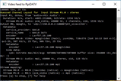

Thanks Alain,
The instructions worked fine, I noticed the stream is mpeg2 should I try to change to H264 for the pi?

Post by F1CJN_alain » Tue Mar 15, 2016 3:16 pm
Yes you can.
I did this to get access to the Paris F1ZHF ATV repeater, using MPEG2
Thanks, I am going also to try it with H264 because it is much better for ham radios.
