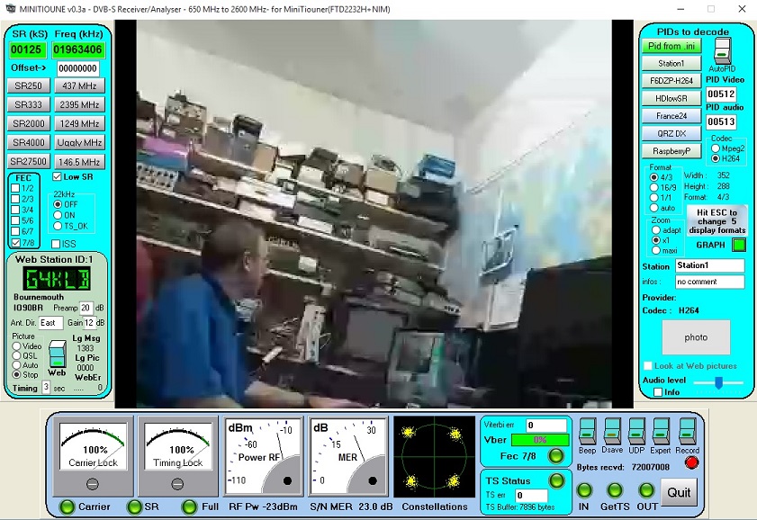

How low can we go!!!!!!!!!!
First test at SR125
G4KLB

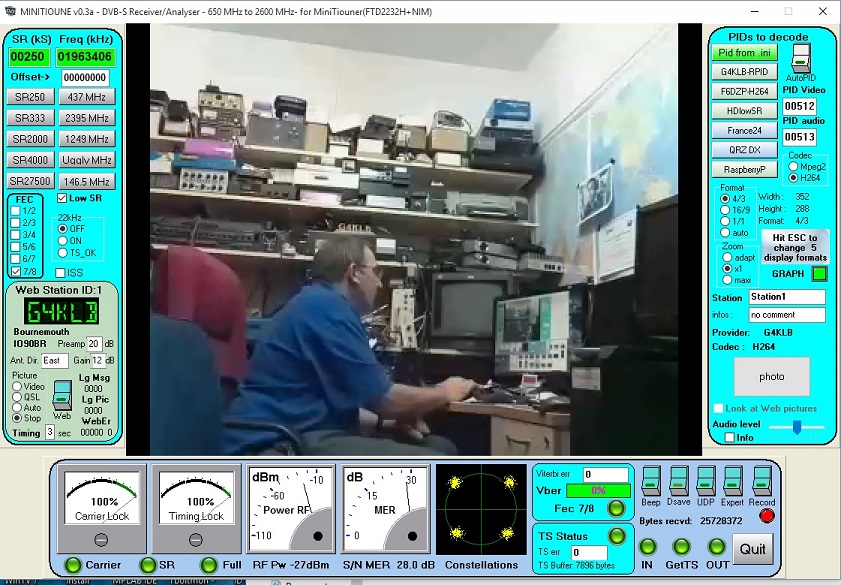

Very usable at SR250 :D
