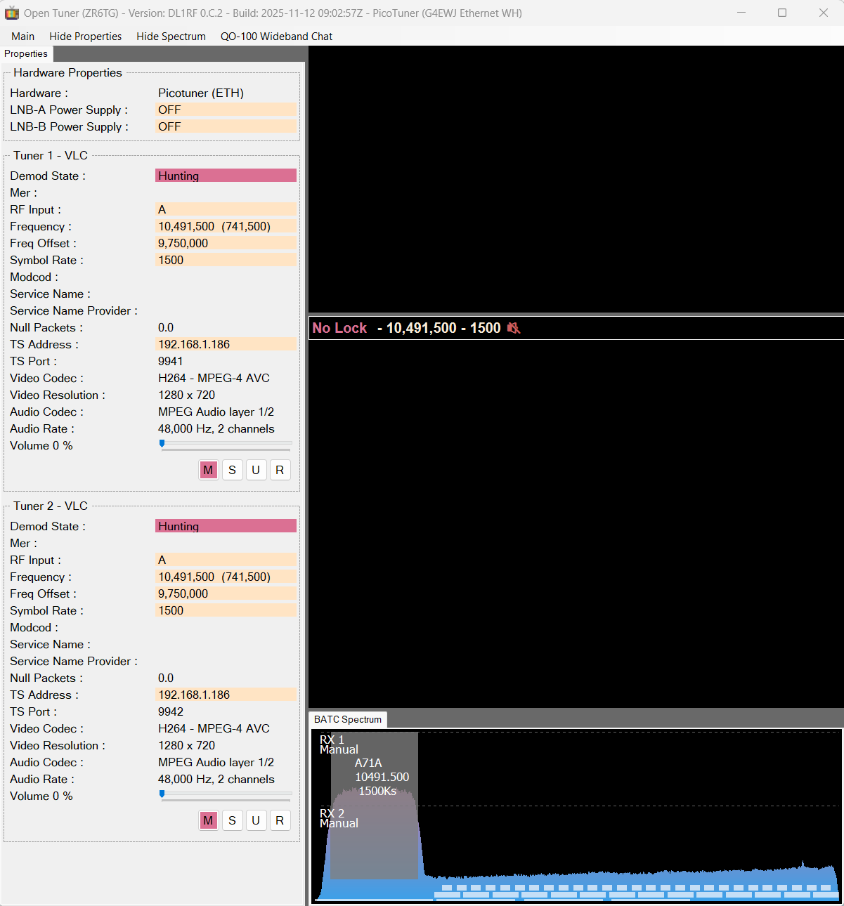

Great - very good in fact - except it doesn't work properly for me as there seems no way to set the LNB volts on my ethernet connected picotuner. I can fool it into working by setting those with Rob's quicktune, but not from Opentuner itself. This setting is just not available in the source settings, whereas it is for USB connected tuners. There also seems no way to stop it apart from closing it down. Maybe I need to look at the manual again, it has been a while.
The LNB voltage control works perfectly, provided that the RT5047A type DC/DC converters for the LNB voltages are used.
You can select the voltages in the "Hardware Properties" field using the right mouse button.
See the attached circuit diagram of my PicoTuner.

You have to right click on the orange bit? I had tried left clicking.. I see - but hardly intuitive. It would be better to set it in the setup like all the other interfaces?
