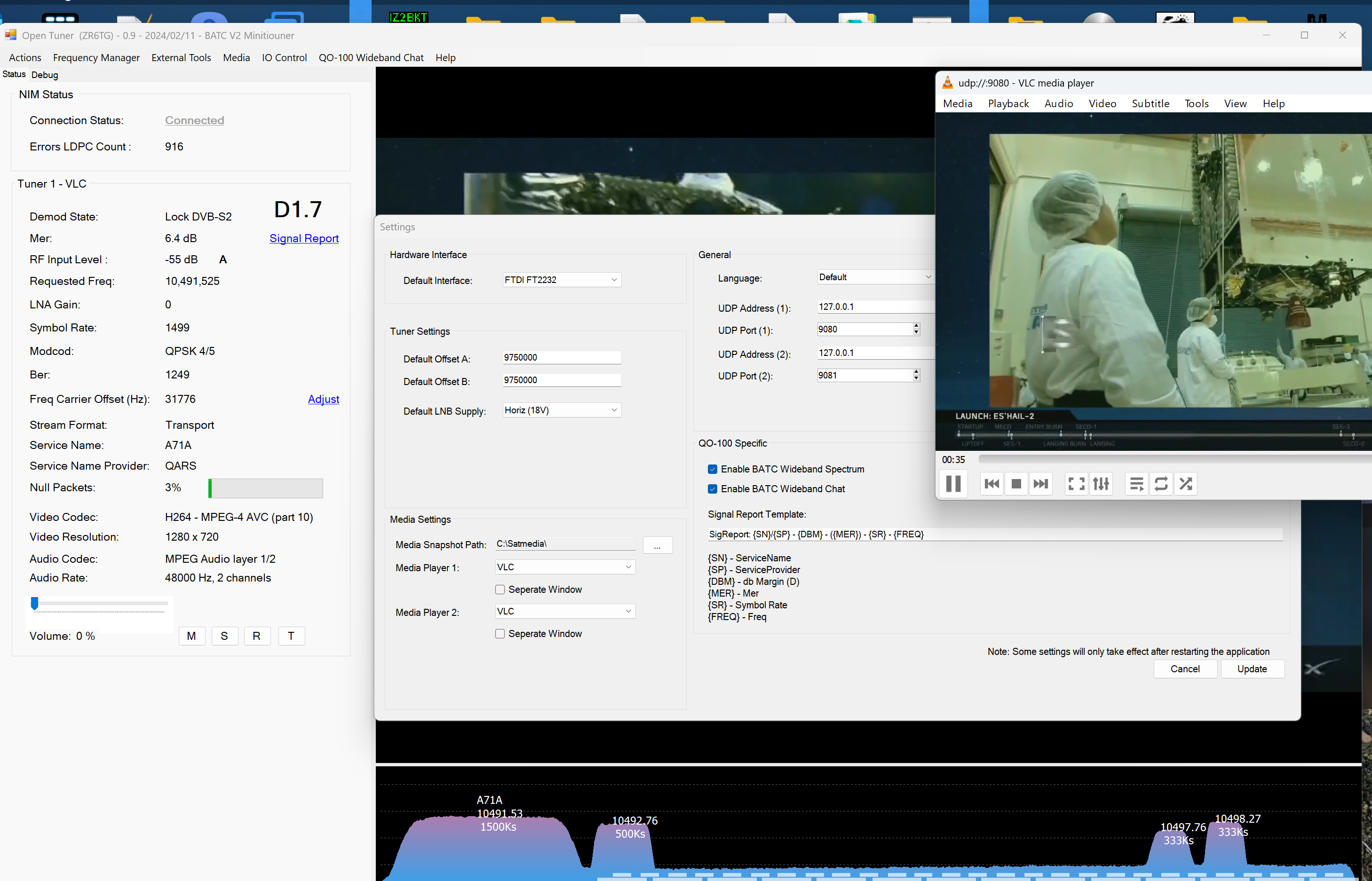

Hi
I am trying to send from opentuner 0.9 a stream to another PC on my network. Attached is a screenshot of how I can see the steam on the same PC but failing to find the parameters to stream to the networked PC. I know 127.0.0.1 needs to be changed to ip address. Which one and what are the settings for receiving the stream in VLC?

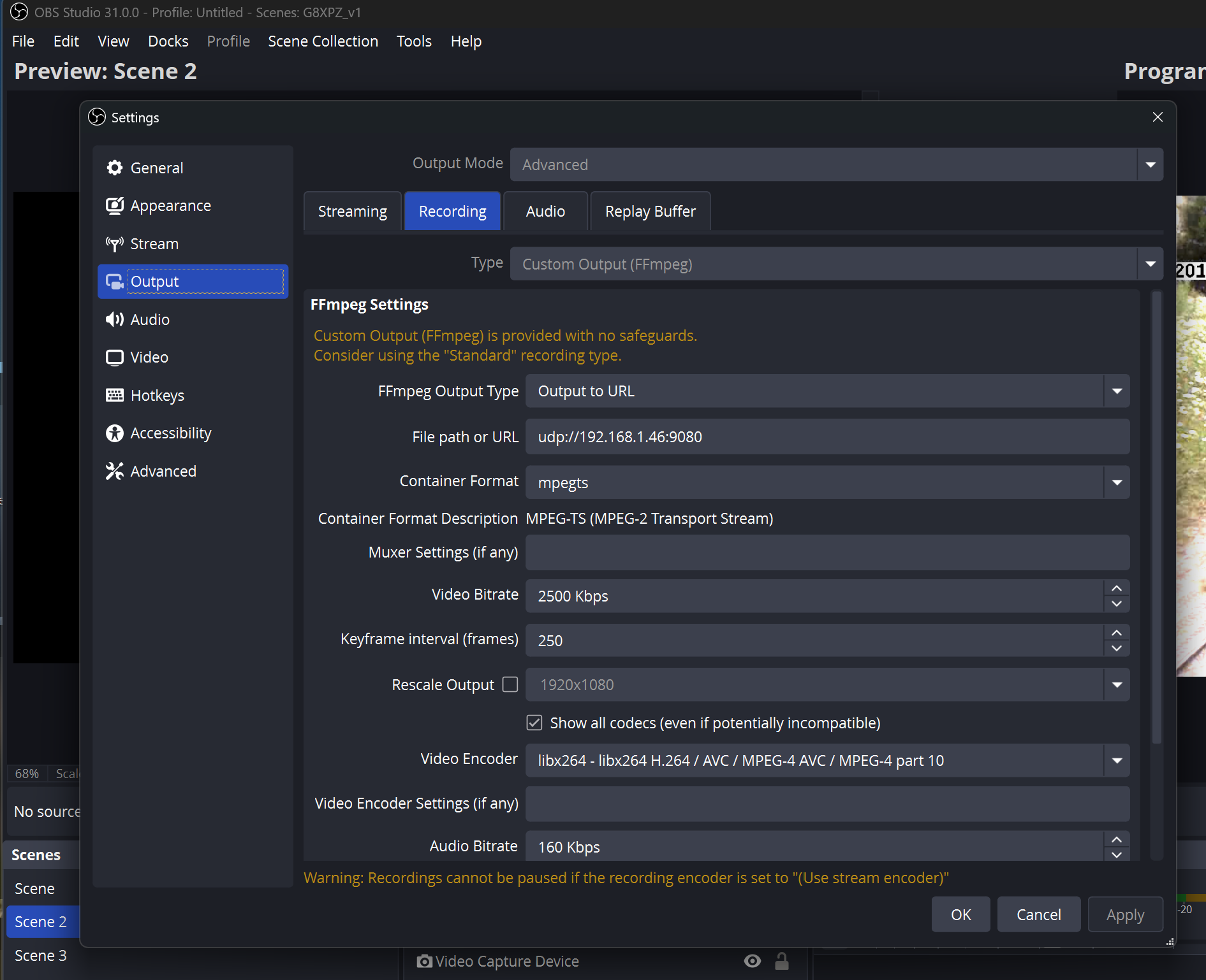

Also trying to do send via udp from OBS Studio to a networked PC via recording mode but cant seem to receive that either?

Hi, set the IP address of the PC you wish to send the stream to in Open Tuner and the port (say port 5000)
As you know, set U as marked in Open Tuner. If you don't know the IP address of the PC you want to stream to use something like Advanced IP Scanner (free) to scan your network and find the relevant PC's IP address.
At the PC you want to stream *TO* open VLC and under Open Network Stream set the network URL to the SAME PC you are streaming TO. And set the same port number in the format udp://@***.***.***.**:5000 where the asterisks are the IP address of the PC you are streaming to and has VLC open. Kind of counter intuitive to me, but that is what works for me....
You may need to manually open the relevant ports if they are not already open in the Windows Firewall. Careful there....
Be sure the PC's are on the SAME actual network and one is not on a subnet, that's more complicated and beyond my IP knowledge.

Hi Chris
Thank you for your reply.
I now have udp working from opentuner 0.9 to another PC on my network.
Your explanation was great - eventually I found that one PC was on a public network and the other was on a private network so undiscoverable! Changed network type and worked.
Now to try with obs-studio.
73s Steve
G8XPZ
