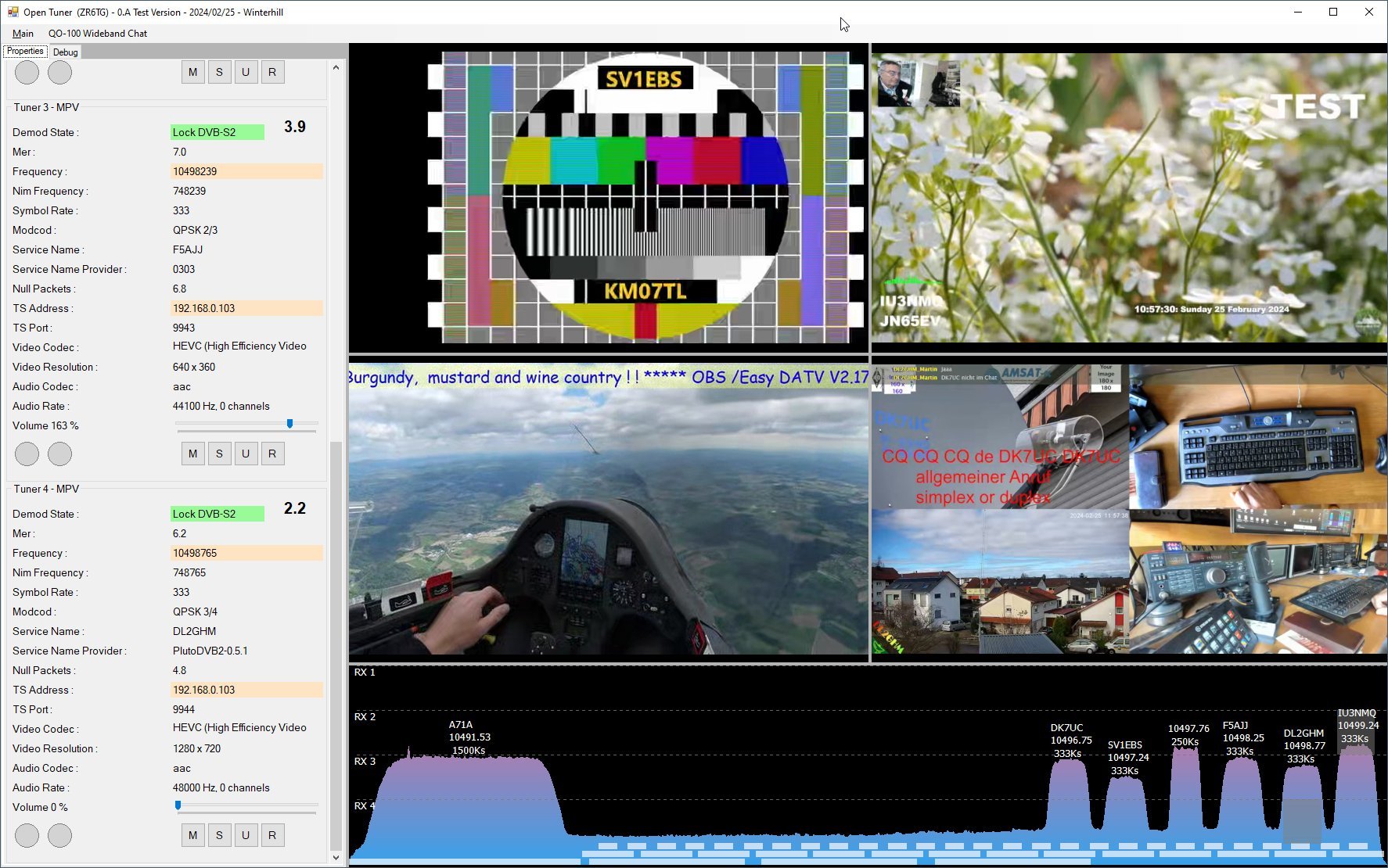

Thanks again for your sterling work on OpenTuner Tom, latest version up and running, just investigating the updates, the first thing I find excellent is the ability to "squeeze" the LH window to give more real estate to the transmissions. Wonderful stuff, and much appreciated.

Testing OT-0A with the Winterhill receiver
Today I tried the net version of Open Tuner with my Winterhill receiver. It works great! A real nice addition to the older versions
