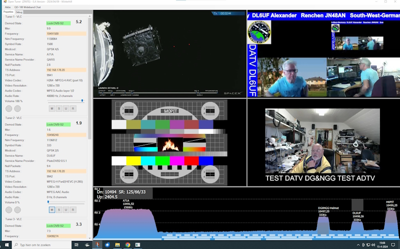

Thanks again for your sterling work on OpenTuner Tom, latest version up and running, just investigating the updates, the first thing I find excellent is the ability to "squeeze" the LH window to give more real estate to the transmissions. Wonderful stuff, and much appreciated.

Testing OT-0A with the Winterhill receiver
Today I tried the net version of Open Tuner with my Winterhill receiver. It works great! A real nice addition to the older versions
Many thanks to Tom ZR6TG for his great work!
A few small things I came across:
A special winterhill version is needed, found on github. When you retype the "wget xxxx"line on your raspberry, the underbar character between install and winterhill.sh is hidden, it took me a while before i realized this. Cut and paste in a SSH session works better.
After installing everything, i could not configure the IP address an LO offsets in OT, the settings window shows corrupt. Finally i edited the winterhill.json file in the settings directory. Problem solved.
The winterhill RPi refused to send the udp streams to my computer. I needed to edit the whlaunch-anyhub-3v20.sh with entering the IP address of my PC instead of the zero. (this should not be needed ??)
73 Rob PE1CHY
