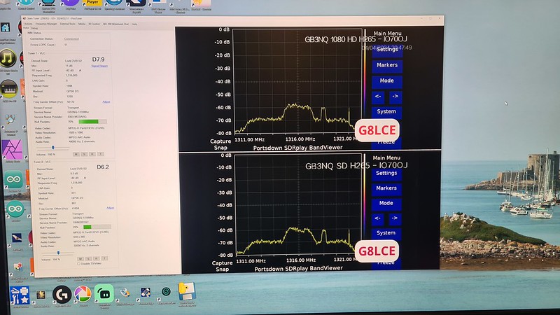

Seems simple but try changing the USB lead. I had a similar problem and it was the USB lead. Not saying the system is 100% but it is much better now...
Note that this is GB3NQ transmitting on 1316Mhz 1080 HD and 1318MHz 480 LD (2000ksr & 333ksr)
Martin G8LCE
Martin G8LCE
