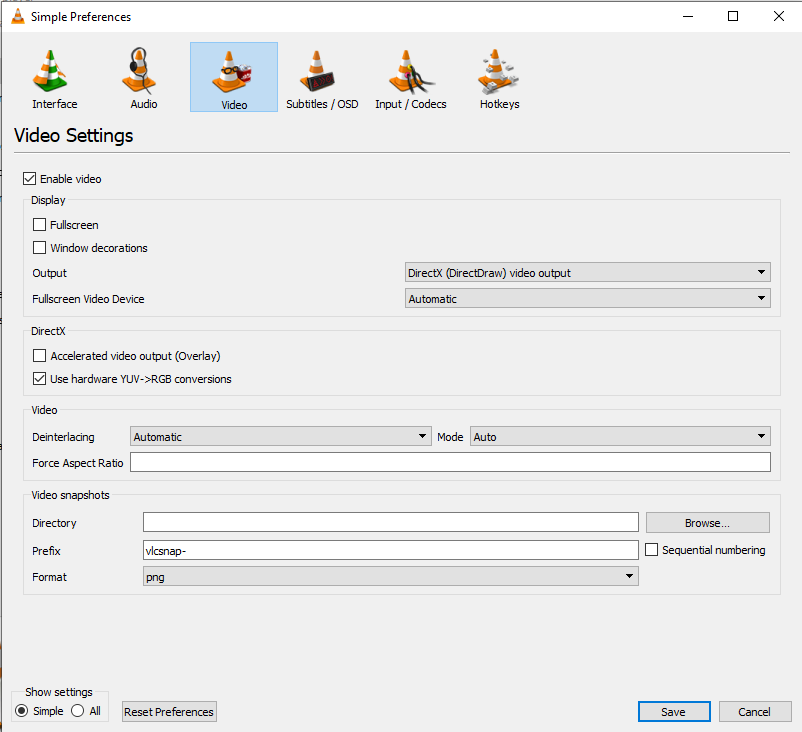

The settings I had to change were in the VLC program under 'Tools / Preferences / Video'
Changed Display Output to 'DirectX(DirectDraw) video output'
Unticked DirectX Accelerated video output (overlay)
Colin G4EML

Thanks, have tried it but no difference I can get the top channel if I toggle chn a/b, if I toggle 2nd chn the system hangs up, if connect again it reports no hardware found so at a loss now, works on portsdown 4 with some lockups saying no tuner found.
