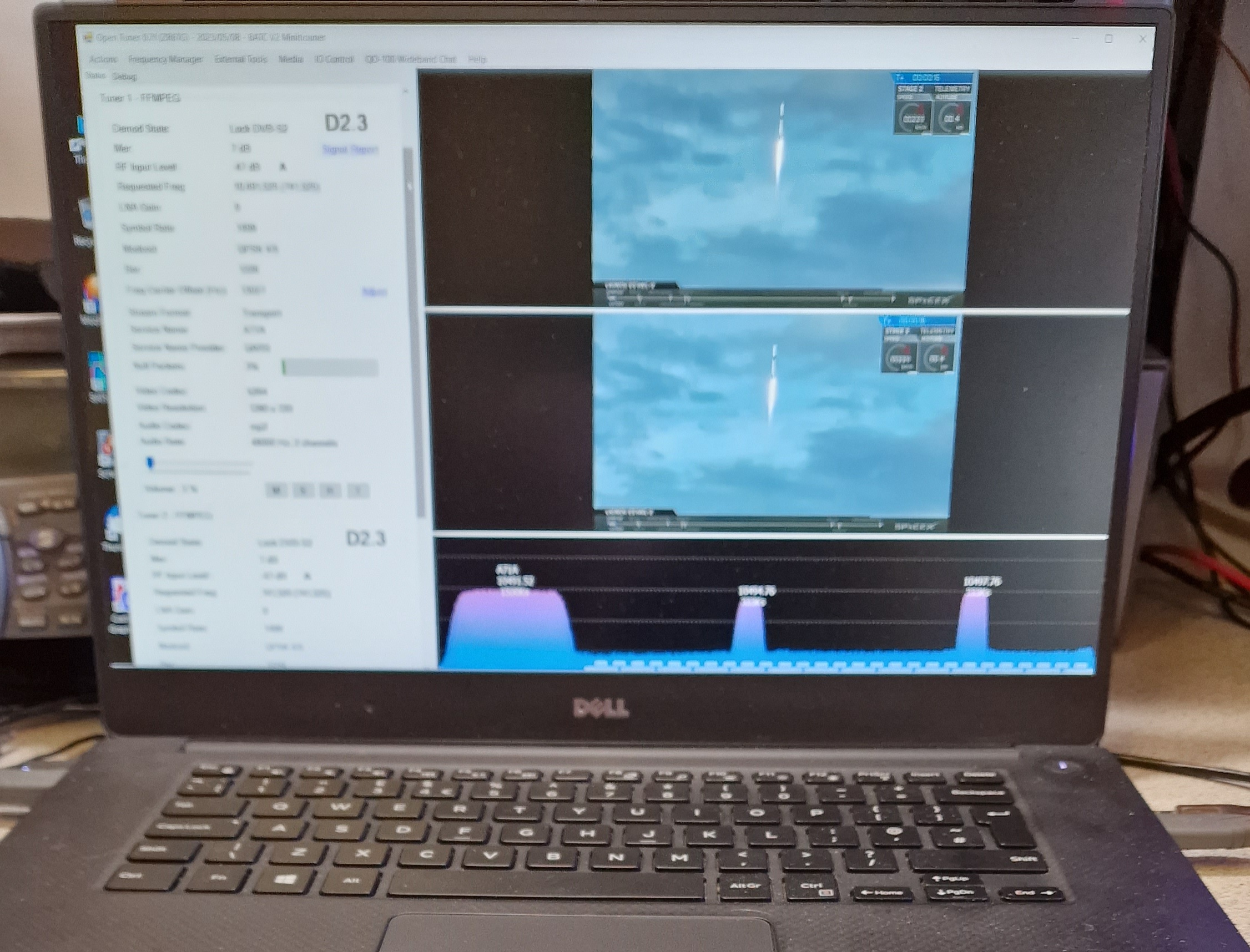

Having issues getting 2nd video on minitiouner v2 with opentuner, the small daughter board calls for a 74HC10 but can only find them with extra part numbers like /n etc, does this matter or has it to be 74HC10 only.

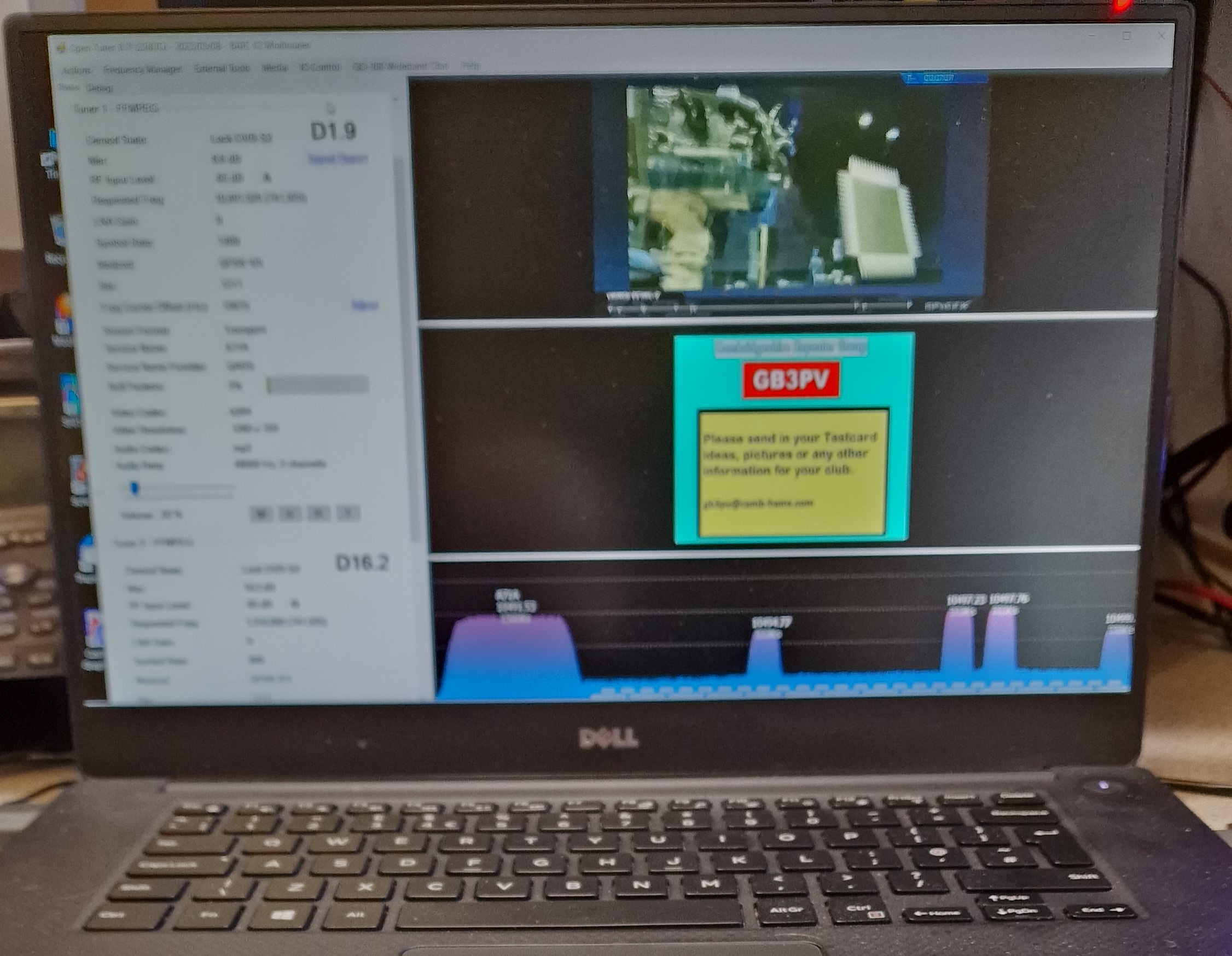

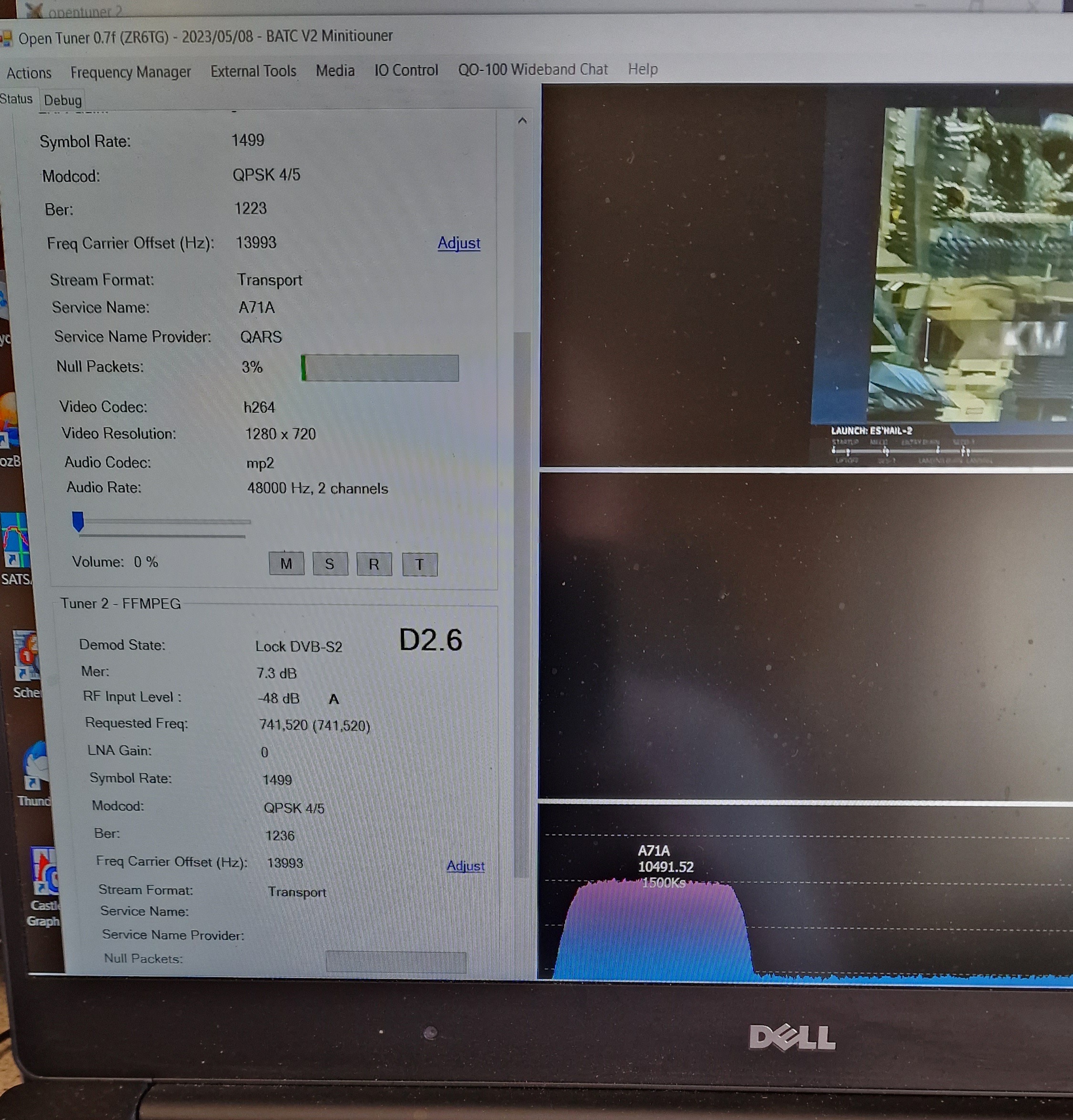

Thanks for all the replies, but as I said you may have a duff 74HC10, I did duff final o/p to usb module so use a socket.
So all working after putting a scope on the chip to check signals.
Thanks all and Tom ZR6TG
