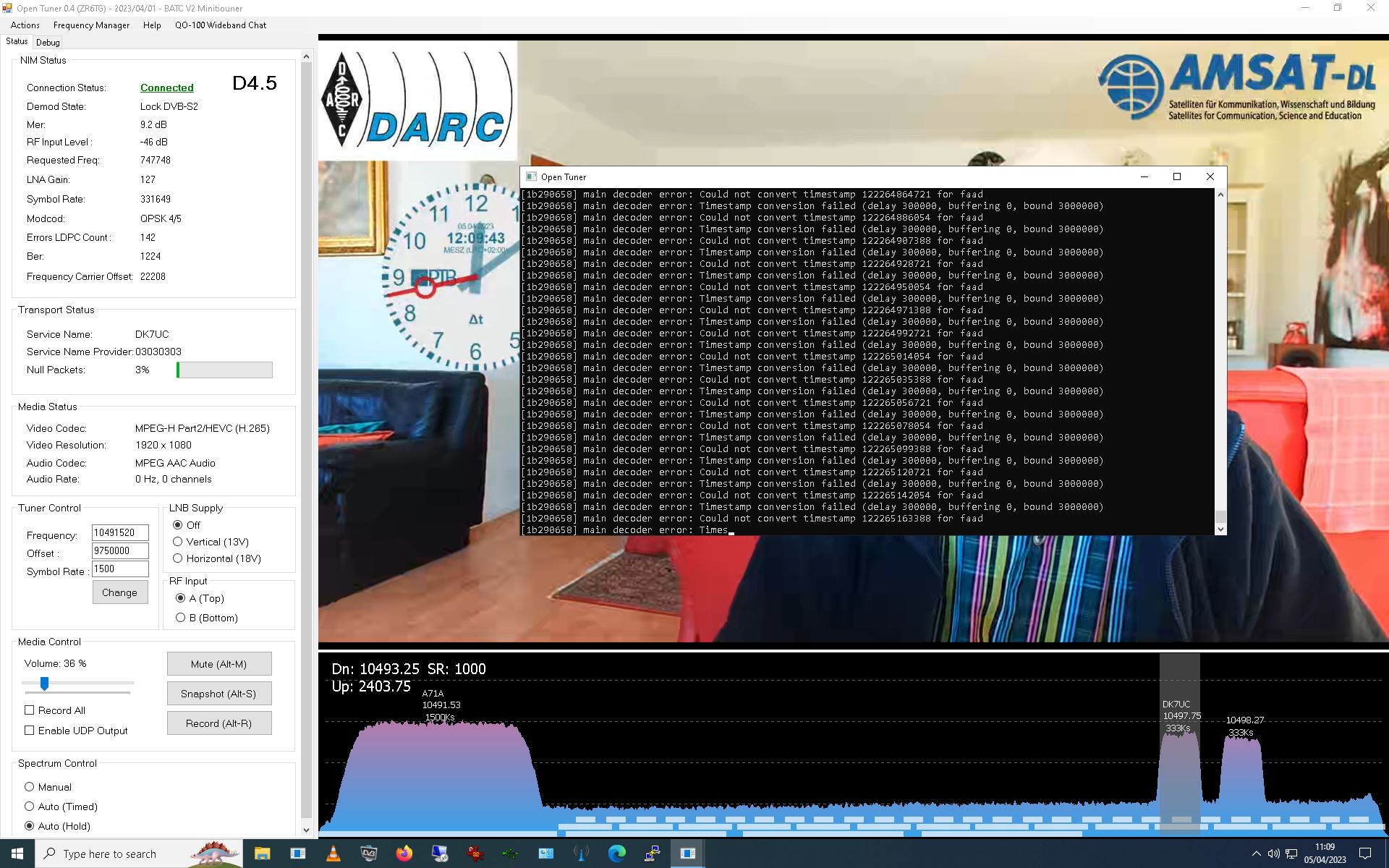

Not sure what the timestamp error is, but I have seen it before, so I've attached a screen shot. The video and audio sound perfect despite this.

Post by G4FKK » Thu Apr 06, 2023 8:41 am
I've seen this too. If you leave it long enough it seems to crash the minituner.
