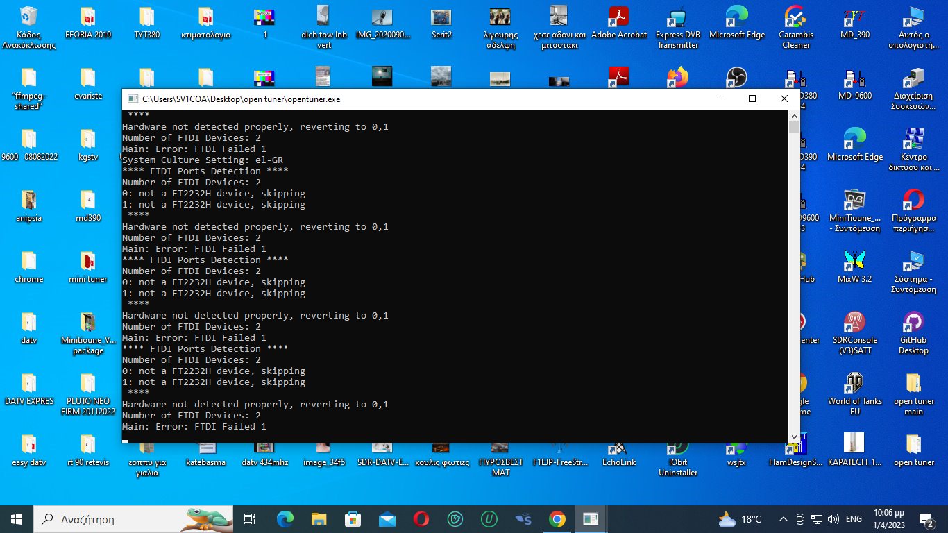

Hi Tom, I'm having trouble with the open receiver connection, I've tried many times but the problem persists, the message is the hardwear not detect properly, i have win 10 end may mini tioune is v2.0 73 from yiannis SV1COA

I suggest that you test it without DATV Express (and any other USB devices) connected, so that the developer at least has half a chance of diagnosing the problem. And a copy and paste of the associated command window would help as well.
Have you added the resistor mod to to your tuner? You don't say which version of MiniTioune works for you.
Problem reports like yours where the reporter has not made any attempt at diagnostics are immensely frustrating for developers; I speak from bitter experience.

sv1coasv1coa wrote:
Sun Apr 02, 2023 5:25 pm
Hi Yiannis,
Thanks for that. From what I can see on the supplied logs (Thanks!) is that its detecting ftdi devices, but not the expected ft2232 module. I might have missed it, but what hardware are you using? Do you have other ftdi devices plugged into your pc? or multiple minitiouners? I'll add some reporting that will show what chip it detected, any more info you can give will help me resolve this.
Thanks,
T
