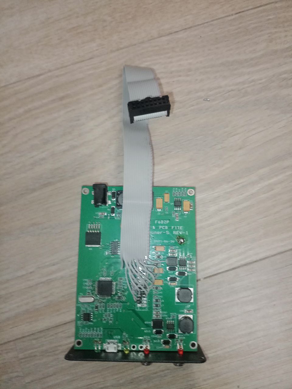

Hi all,
Found the problem a duff 74HC10, glad I put an i.c socket on the pcb, all working so thanks all and Tom ZR6TG.
- 20230511_183452.jpg (919.03 KiB) Viewed 23073 times
Re: Open Tuner 0.7 - Dual Tuner/FFMPEG, etc
Ebay? My patience quotient just rose...
Will have things socketed... Thanks for letting us know the cause Brian.

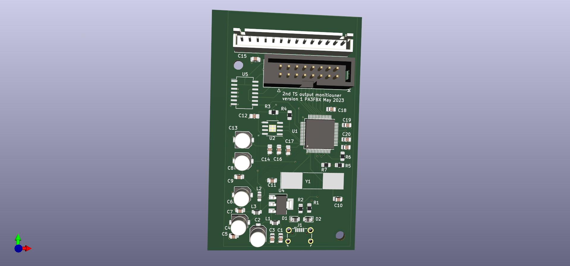

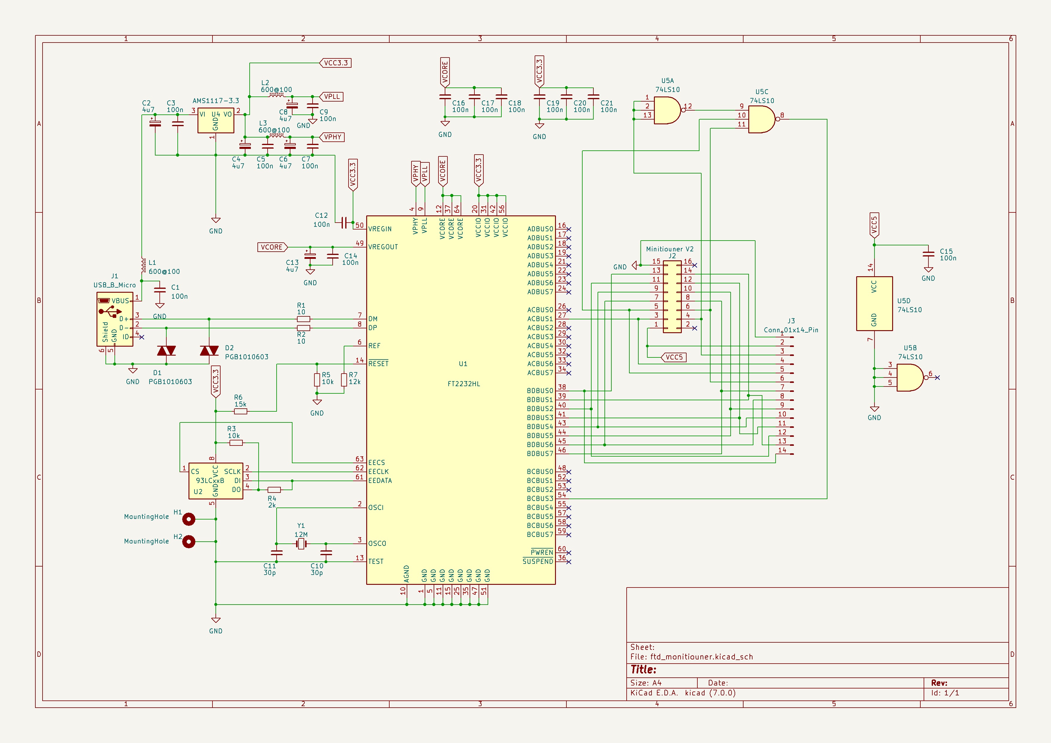

The dual TS will also work on the minitiouner S- but the Hugh expensive ftd mini module will never fit into the original box.
This made me look for a different solution.
I draw kicad the schematics and an pcb witch fits with only the needed 14 output wires.
I made a 10 piece shipping from china and it seems to be under 15 euro.
So i might have an solution for those who cannot use the batc minitiouner version 2 solution.
Benno
