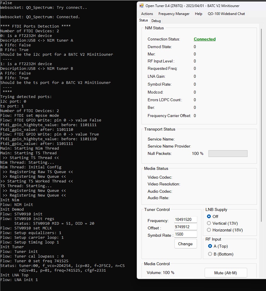

sorry no circuit diagram, but see the debug attached it says its using ts port 1 I know in Minitioune I had to set it to TS2 as it was set to use TS1 by default. Although your software connects its not doing anything there after and just sits there with zero's next to everything. Hopefully this is clearer as to the issue I have, I'll open up the MT if needed to take a picture of how its wired up.

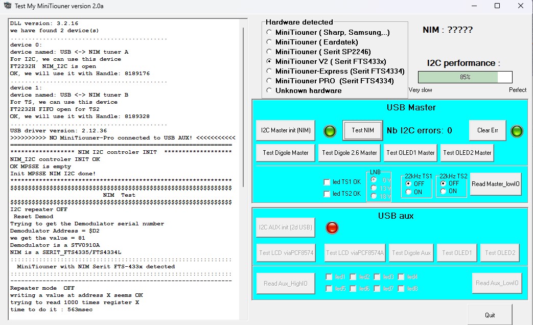

the above is the output of the MT test you can see it's set up for TS2

John, this seems to indicate that there is another issue not related to the TS. Even if the TS was pointing to the wrong one then it would still show the tuner information. Its clearly communicating with the NIM, but its not getting the required data. Can you try starting OT with the DISABLELNA command line parameter and see what it does

yep that fixed it any idea why ?
73 John

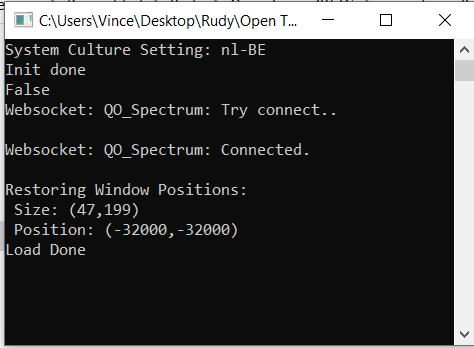

Open Tuner_0.7f_20230508 worked perfectly all day on my Win10 PC with the Minitiouner-S + extension. And then suddenly it still starts up but I don't get the normal screen anymore. I just get the following screen.
Anyone have an idea what's going wrong?

To me, and it's just a guess, it seems OT is not able to access any FTDI devices on any USB ports. I think I'd reload OT from scratch and see if it sorts itself out. It should progress after your OT stops to interrogating the USB ports for FTDI devices.

Edit config.
%userprofile%\appdata\local\Amateur_Radio_-_ZR6TG
into a run dialog and get the folder
for example:
To open run dialog:
Windows Key + R
Then entrer
Go into that folder and there will be a user.config file you can edit to restore settings.
I just deleated all the config files restarted OT and configured it to my settings.
I think OT is being displayed on a screen you don't have.
Hope that works for you!
