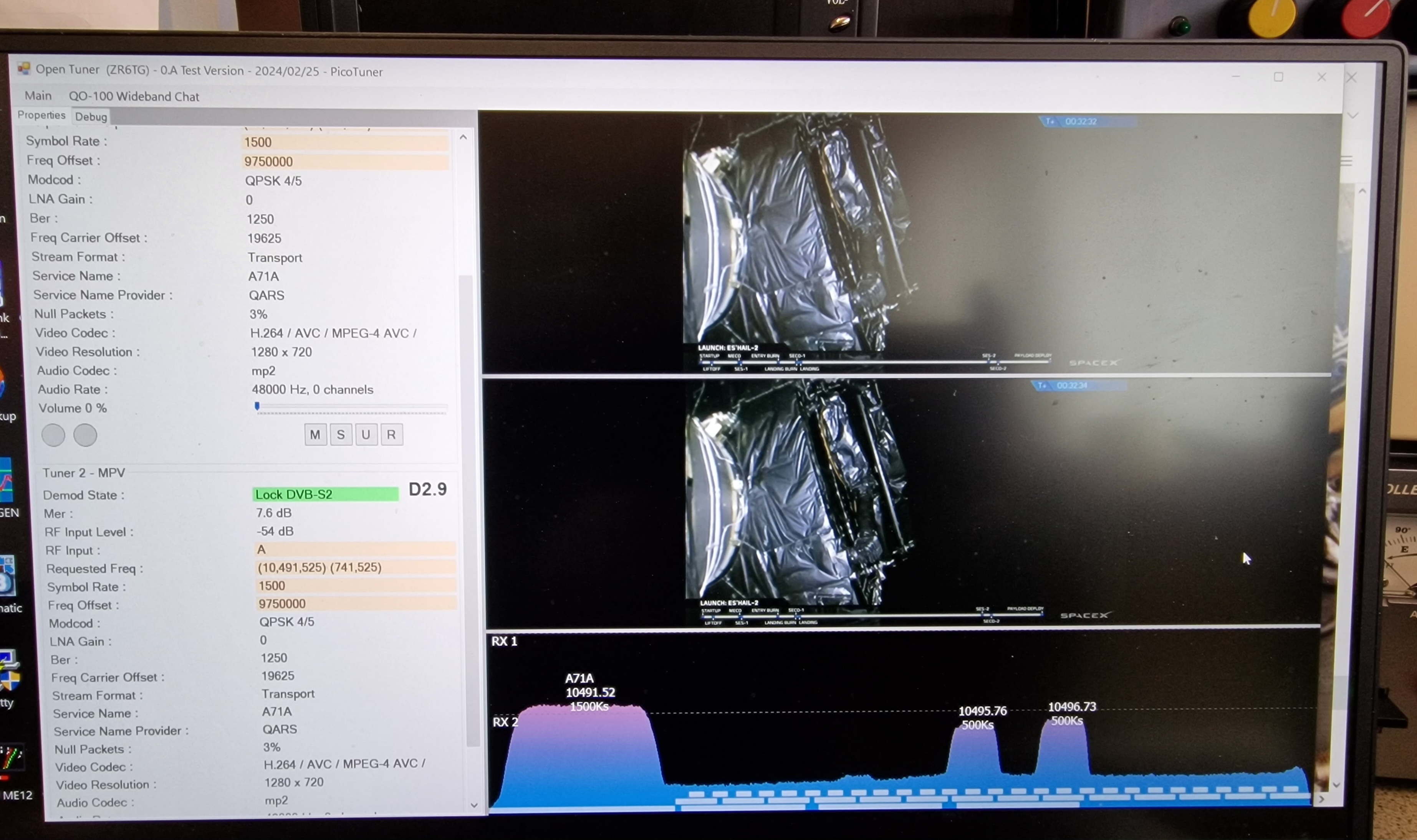

Hi Colin,
My mistake two wires crossed on j1 of pico pcb, both channels working.
Than you for your input to this project.

Sorry, i got to this late. Glad you got it sorted Brian. 9/10 issues so far has always been related to wiring, especially if its connecting.

Colin,
Thanks for all the help, sorted 2nd channel wires crossed on j1 pico pcb.

Hi Colin,
All working now, thanks

I had a similar problem, actually worse as the second TS crashed. Here's how I resolved it:
1. Make sure in OT you have both windows on seperate connectors Top-A Bottom-B (the second option)
2. Delete both device drivers (in control panel) and re-install them and double-check they have different addresses when you re-install. It seems that the driver install is not 100%.
