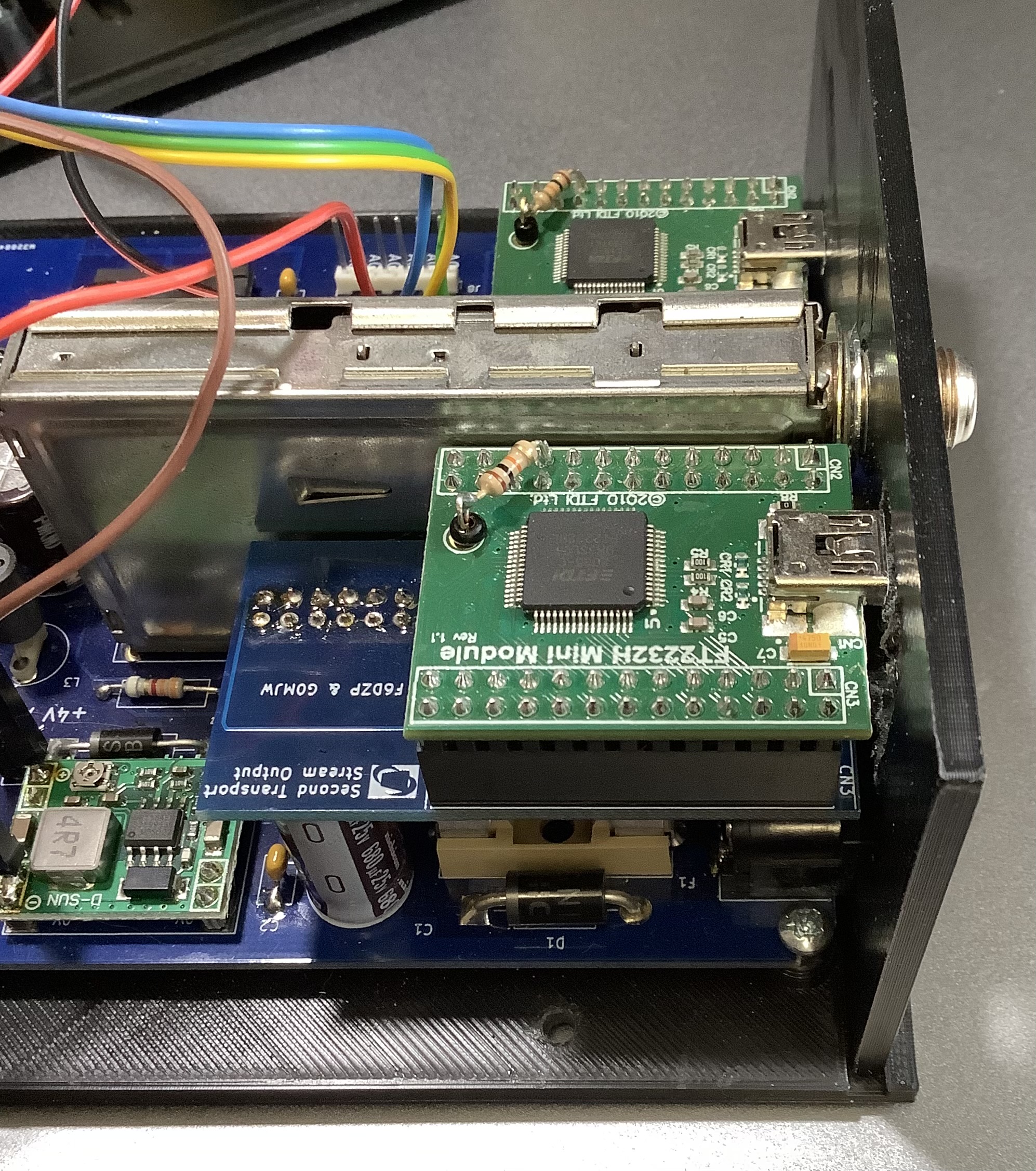

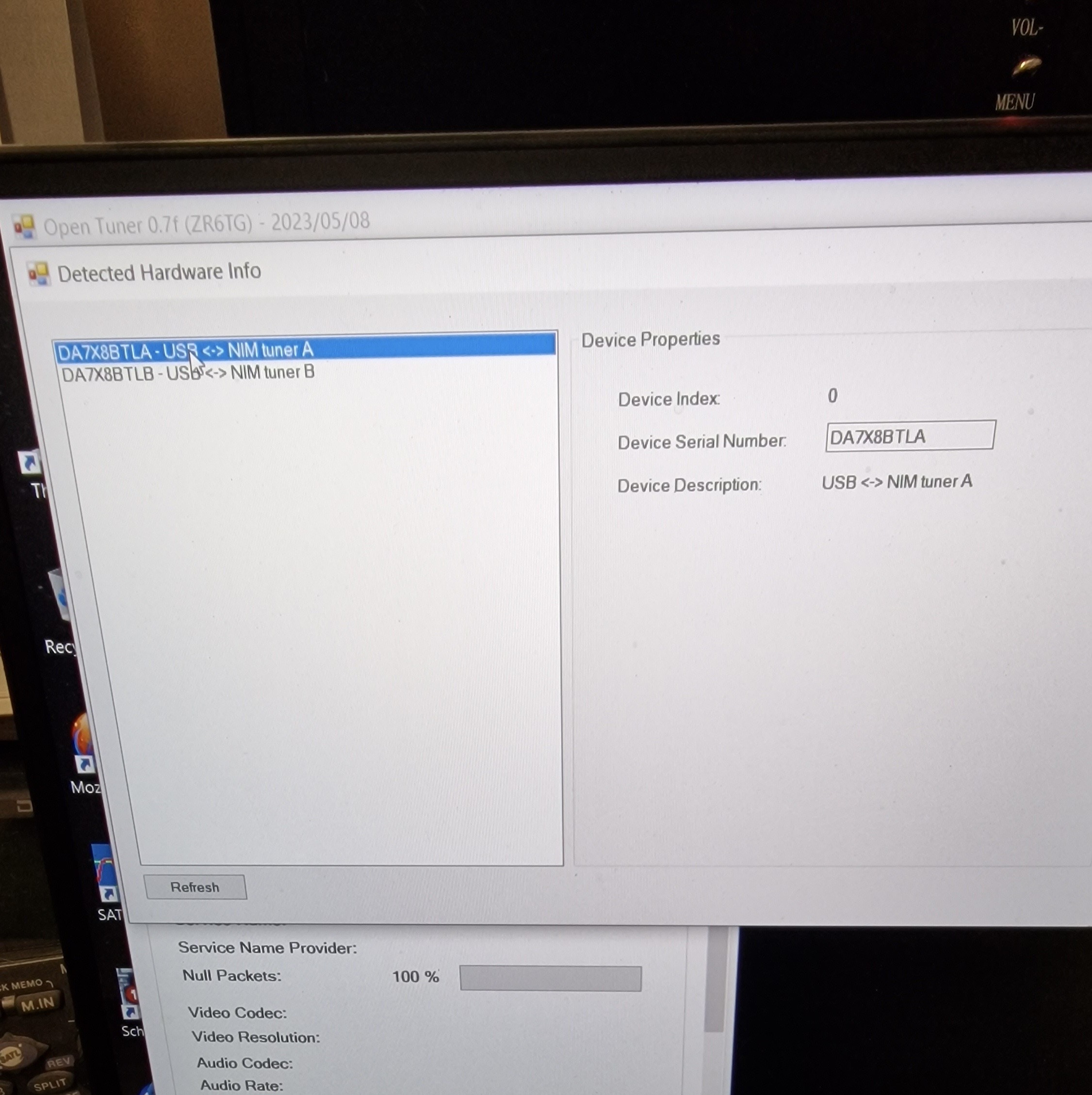

Has any one got this working with the BATC minitiouner v2 add on second usb port,it sees both usb ports in info, but when connect click it opens a single screen on B input and no decodes, both usb modules work in single channel usb mode on A
Brian (G6HFS

Brian, I sent you an email. It doesn't look like your usb module is programmed correctly, so OT is not detecting it properly and only showing 1 video. Your screenshot shows USB <-> Nim Tuner which is the original one, the properly programmed one will have the DB in the descriptor. Make sure you apply the template when programming it, also make sure you unplug and replug after programming so it enumerates properly. Its been done by a few people so the software is good in detecting it properly.

Tom,
Will look at it again, both usb modules are from the batc shop, and came programmed both work in the original position Tom not using the second pcb, both mintioners work as I have two I have a third on order, I just used one module as a test in the other so I will try re-programming if you think it not correct.

I have yet to assemble my second board, but I was of the impression the module needed programming DIFFERENTLY to the first one, so I would not expect the pre programmed one from the BATC shop to work out of the box. See:
https://www.zr6tg.co.za/adding-2nd-tran ... iouner-v2/
Hope that helps.
