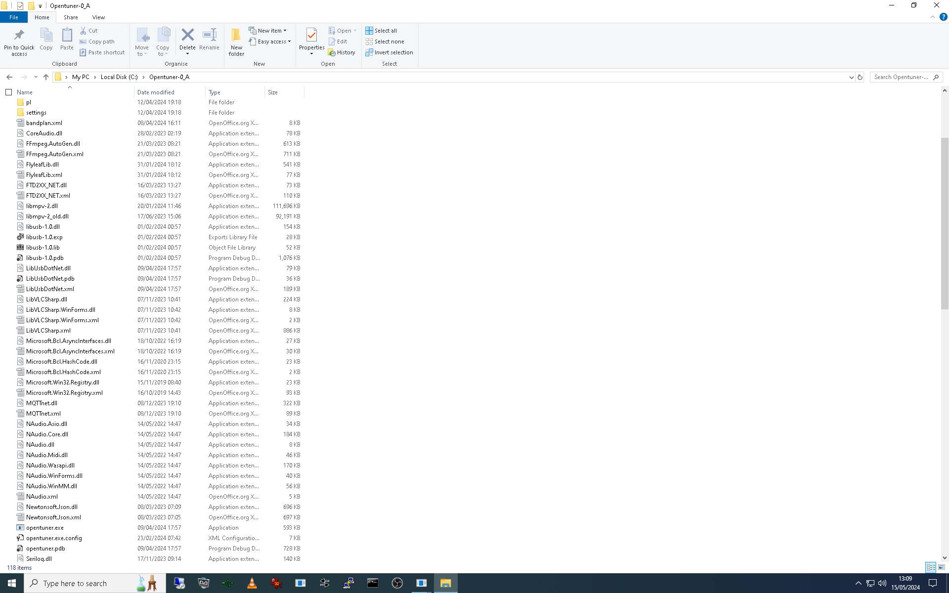

I don't know if this is going to help, but here's a screenshot of my libUSB files and sizes from a working OT 0.A application.
The only crash issues I have had on start up were when I had changed the order of the decoder windows.
Here's a screenshot, good luck!
http://www.chriswilson.tv/libUSB.jpg

Hi Basil!
Thanks for your answer.
Unfortunately it didn't solve my problem, but it helped. as I now know that the files in my installation directory are probably correct. I have now switched my Windows to English to make the screenshots here in the forum easier to read.
It may be due to the chipset used in this Lenovo Thinkcenter (see the corresponding attachment for system information).
Since I couldn't notice such behavior on any other PC I installed OpenTuner in the meantime
