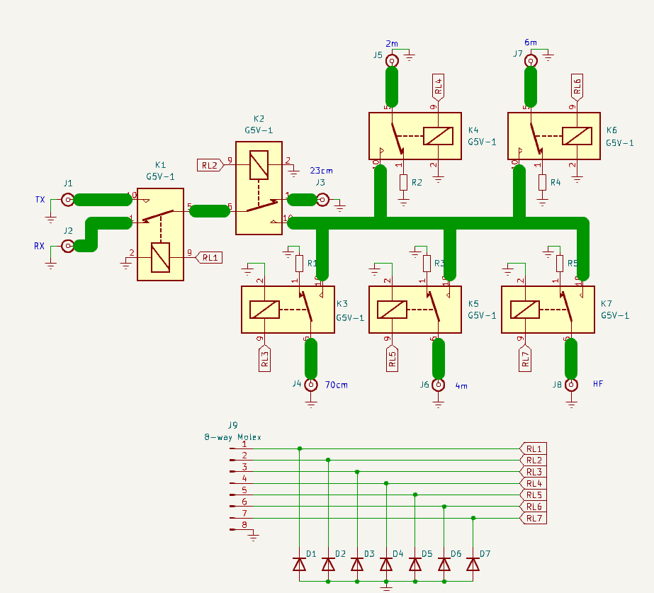

Certainly up to 70cms, as long as you don't want too much isolation, you can use miniature 12V relays. Maybe we should design a PCB for this? Something like : Maybe?gu6efb wrote: ↑Wed Jan 29, 2025 11:16 amHi Mike

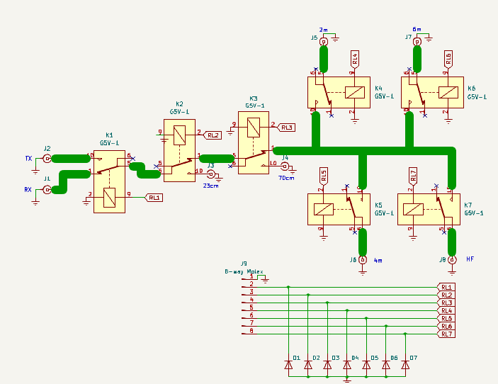

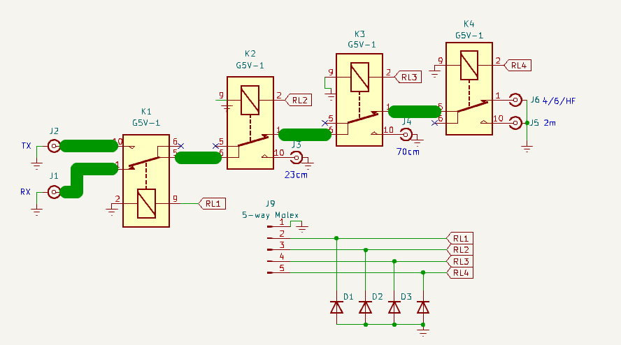

Or maybe
Though the board would need to be on 0.8mm PCB to make the 50 ohm tracks thinner. The idea being that the higher bands have the easiest path and other bands, where it doesn't matter so much make do with a bit worse.
Put it in a Hammond diecast box and a 4 port version as who needs 6.
