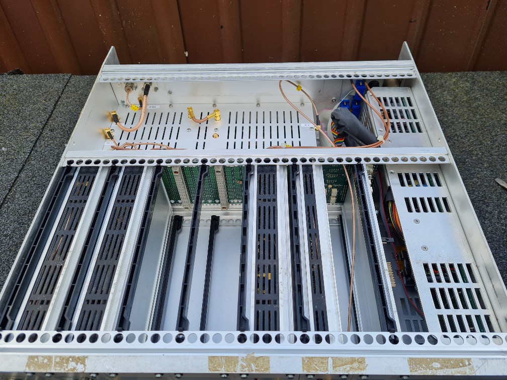

Hello all.
John G7ACD has kindly donated a 3U sub-chassis towards my next Portsdown build. See image. Ron M0RNW at our club suggested I have a go at mounting the individual PCB and modules on single Eurocards.
The wiring still looks like spaghetti despite my best efforts in recent builds so this is appealing.
https://uk.rs-online.com/web/content/di ... -pcb-guide
The prototype PCB'S pictured on the above webpage that use 90 degree connectors to a back plane look interesting but they're £15 to £20 each !
Do any members have spare or unwanted single Eurocard and DIN 41612 connectors that I could have or buy please? I'll be at CAT24.

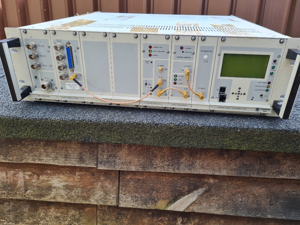

Hi David
The sockets in that rack are designed to accept PCBs without connectors (preferably gold-plated at the edge) like the extender card on the right in the photo below. I do have a couple of gold-plated solder-in edge connectors that might be suitable (also pictured) and will bring them to CAT 24 for you.
At a push, you can file a "key" slot in a piece of veroboard and connect them that way.

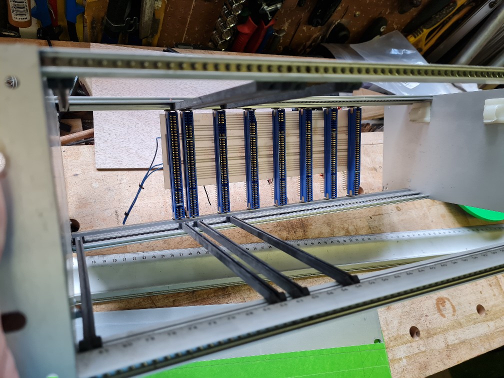

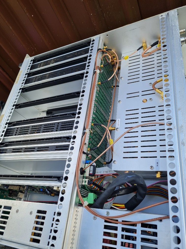

Thanks for the edge connectors, Dave. Pictured is Ron M0RNW's solution - sell me a project box probably built for Eurocards for £20.
It's a Screen Service Italia DBT 200U + XBT 700 from 2007. Channel 25 503.25 MHz transmitter or it was . Large release of smoke after a <crack>! sound from the RF units on the right means it's a project box with maybe a 26 V psu. It's big enough for a Benno PA3FBX sized unit! It's going in the loft unless a broadcast TV enthusiast collects it for twenty quid from IO82WO.
