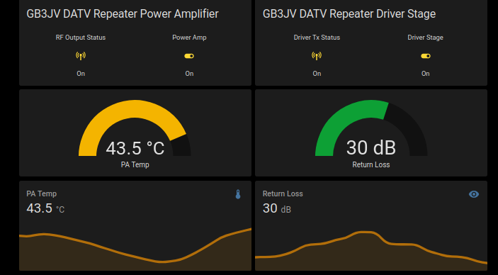

I'm of the view that 2MS/s is a good number, there is plenty of band space after all, at JV I've settled on an FEC of 4/5,this provides a data rate on 3.1Mb/s, but the key to a good coverage is also in the transmitted MER. I'm using an SR-Systems HD Mod that produces final frequency directly (without up converter from 40-1000MHz. I then send this into a Kuhne up-converter, that has very low phase noise and this feeds a Stealth Microwave amplifier and PE1RKI slotted wave-guide antenna. The antenna feeder is only 4m long, as the TX is high on the wall in the elevator room and the antenna directly above, but good return loss is also critical for a good transmit MER. Antenna reflections (standing waves) will impact the actual transmit MER. My transmit MER measured with a 30dB coupler is over 45dB and the shoulders so tiny that I cannot measure. EIRP is 150W at GB3JV and the station can be received on a hand-held LNB 15 miles (LoS) away). The best Rx arrangement is the Norsat LNB (ex-VSAT from eBay Indian shipping salvage yard) with a PE1RKI built launcher and an ex-Wi-Max flat plate antenna.

The control system I described in CQ-TV last year, it has an all-digital signal path, management is using a Chinese ModBUS TCP RTU and terminal server, both from Ali Express (USR-IOT Factory Shop). PSUs from Meanwell and an APC UPS for the whole thing.
Justin.
