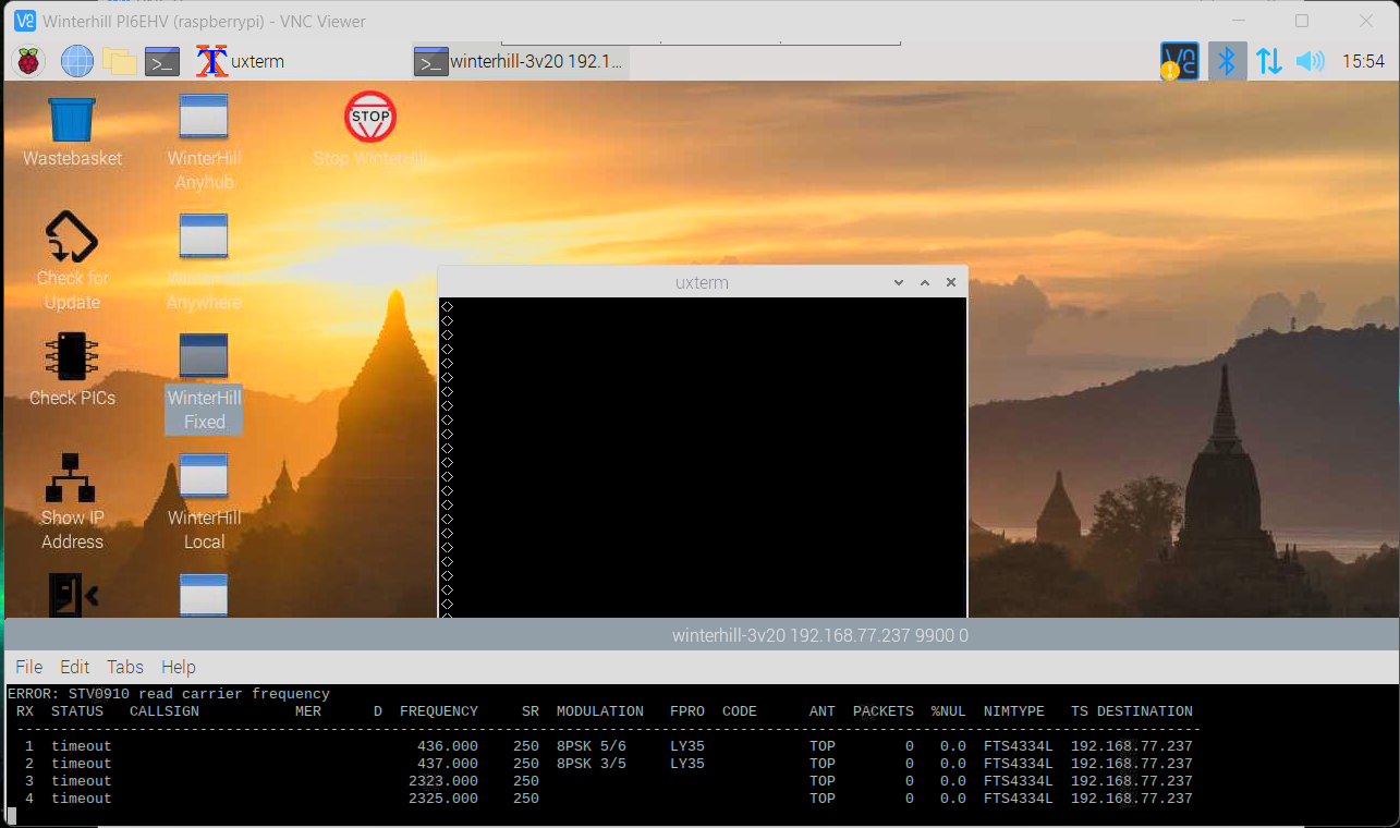

After updating my Winterhill with the latest update from ZR6TG I get a timeout message on all for inputs after a few minutes.
Looking into the screen I also see:
./whlaunch-fixed-3v20.sh: line 3: whlaunch-fixed-3v20.sh: command not found
<31457283>
<27262979>
Any ideas?

I'm not familiar with the ZR6TG version, so I'll let him comment on that.
I assume it was previously working with the standard WH install?
Can you post a picture of the screen showing the timeouts please.

Post by PE5PVB » Mon Mar 25, 2024 3:55 pm

That timeout should only occur when sending off the subnet that the WH is on, but the timeout should be longer than a few minutes.
What is the IP address of the WH? If it's not on the same subnet as the TS destination shown in the picture, then a timeout will apply. It must be more than a coincidence that my subnet is 192.168.77

Yeah I see, subnet is not correct. I think the configuration is overwritten. I'll check.
