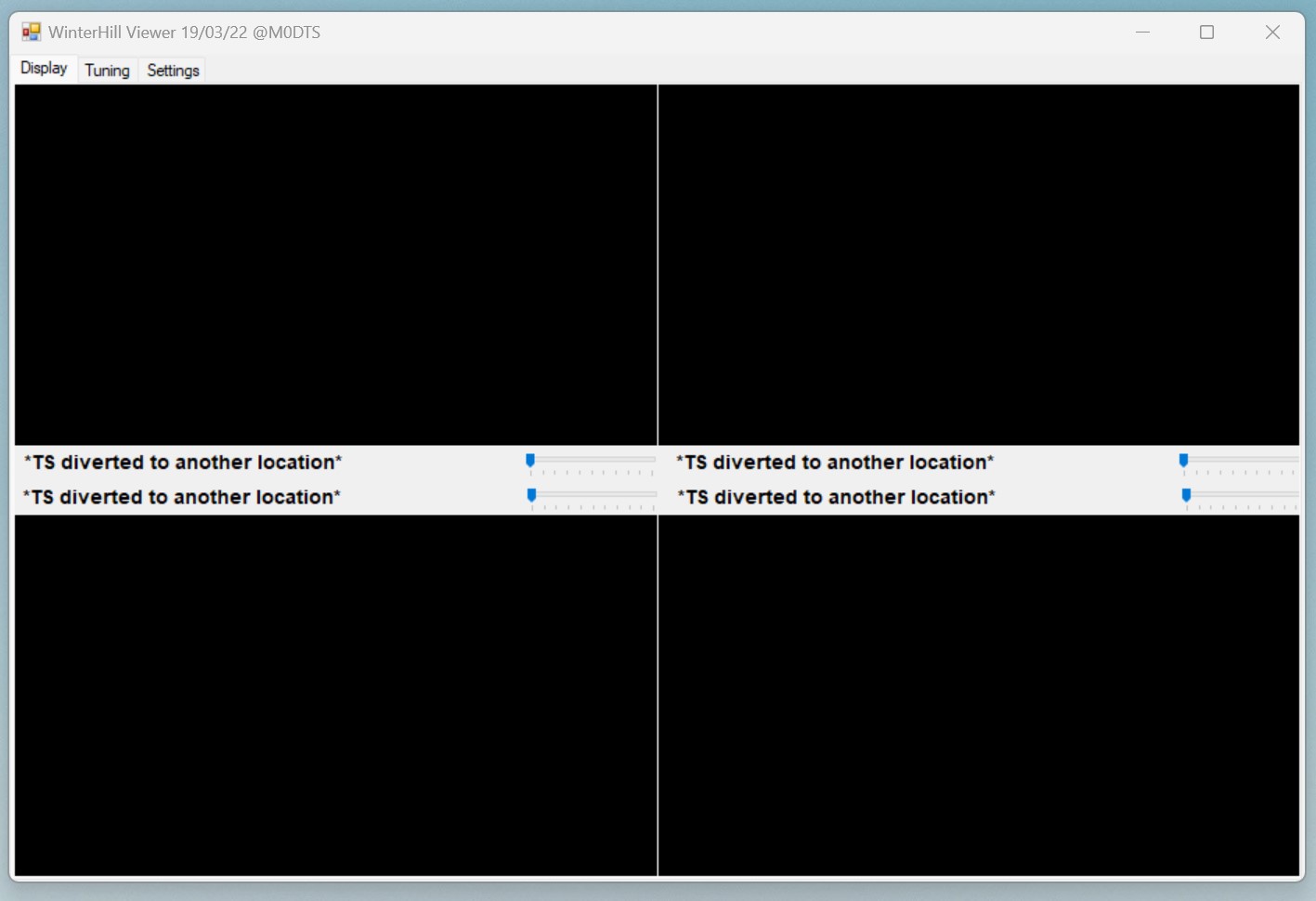

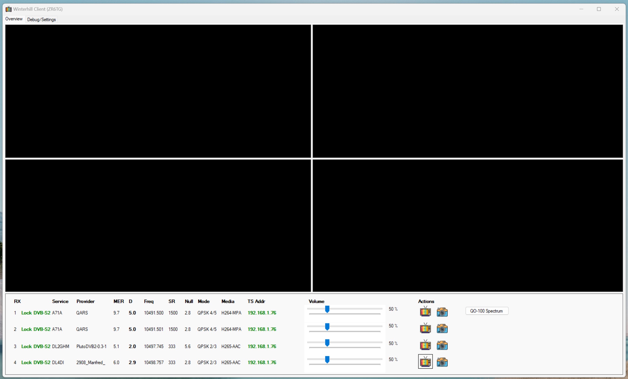

Hi I need HELP! again.
WinterHill whpcviewer software working.
Winterhill Client
I can change the recieved station all green click on Actions get no picture displayed.
WinterHill Viewer.
No Picture displayed and under each window "TS diverted to another location"
I have pinged 192.168.1.203 > 192.168.2.10 and 192.168.1.76 with respone from all.
Windows 11 has just done a big update, has this changed anything?
Winterhill Client
WinterHill Viewer.

Re: WinterHill Software ?
Firewall setting perhaps?
Edit - as in, has the update messed with the firewall settings for VLC. Try briefly turning the firewall off maybe, ideally while your router is disconnected from the internet. Does Rob's stream viewer work? Try updating VLC?
Oh yes, and the obvious, is the PCs and WinterHill's IP address the same as it was before?

VLC uptodate.
Robs WinterHill Viewer dosn't work.
WhinterHill ip 192.168.2.1 hasn't changed.
If it was a firewall problem would I no get a responce from pinged 192.168.1.203 > 192.168.2.10 and 192.168.1.76.
All respond.
All respond.

Not necessarily. It depends on ports being blocked and whathaveyou, but I would start by rebooting your router. I think the routing might be messed up. As in the classic "have you tied turning it off and on again?" fix which works more often than it should.
Shouldn't WH be on a 192.168.1.xxx address?
Isn't 192.168.2.1 used by the Pluto?
You can't run whpcviewer and Rob's viewer (successfully) at the same time, unless you set up for multicast.

Hi Brian,
Yes typo getting old!
WinterHill is on 192.168.1.203
Only trying to run one program at a time.
Martin
Martin

I have restored my PC firewall settings all now working.
Thanks to everyone for your help.
73's
Martin
73's
Martin
