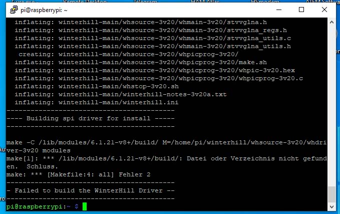

I've been trying to put on the Winterhill all afternoon.
The installation always aborts with this error.
I had first used an 8GB card. Then bought a new 32GB card.
tried with the 64bit and 32bit image for the Raspberry.
Current system as of May 3, 2023.
Does anyone have a hint?

The "/lib/modules/6.1.21-v8+/build" suggests that you're using Bullseye.
You need "Raspberry Pi OS (Legacy) with desktop" which is Buster kernel 5.10.

Hello Brian,
thank you, i will try the Buster-image.

Hello Brian,
yes with Buster-image it works.
And yes: the install lines:
wget https://raw.githubusercontent.com/tomvd ... terhill.sh
chmod +x install_winterhill.sh
./install_winterhill.sh -d
must instead of the lines
wget https://raw.githubusercontent.com/Briti ... terhill.sh
