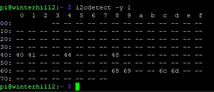

Post by M0DQW » Sun Apr 30, 2023 12:11 pm
Connected my sensor board which contains 4 I2C sensors to the I2C front header on the WH and this is the result, it detected them. I can also confirm that Node Red reads these devices perfectly.
The only thing I did do was to use a 5v line for the INA219 instead of the 3v3 on the WH header.
