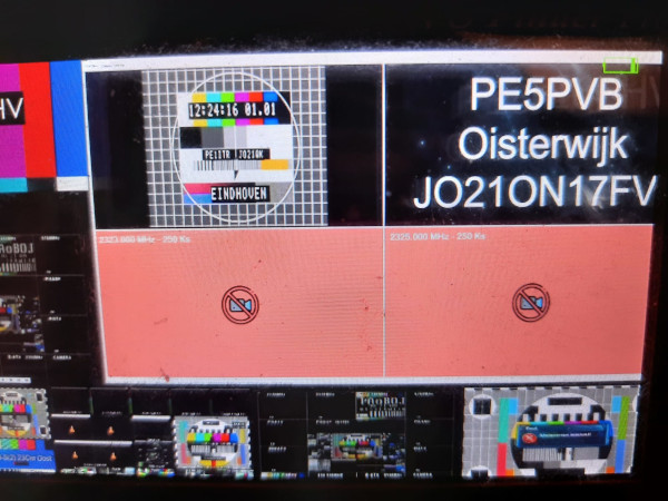

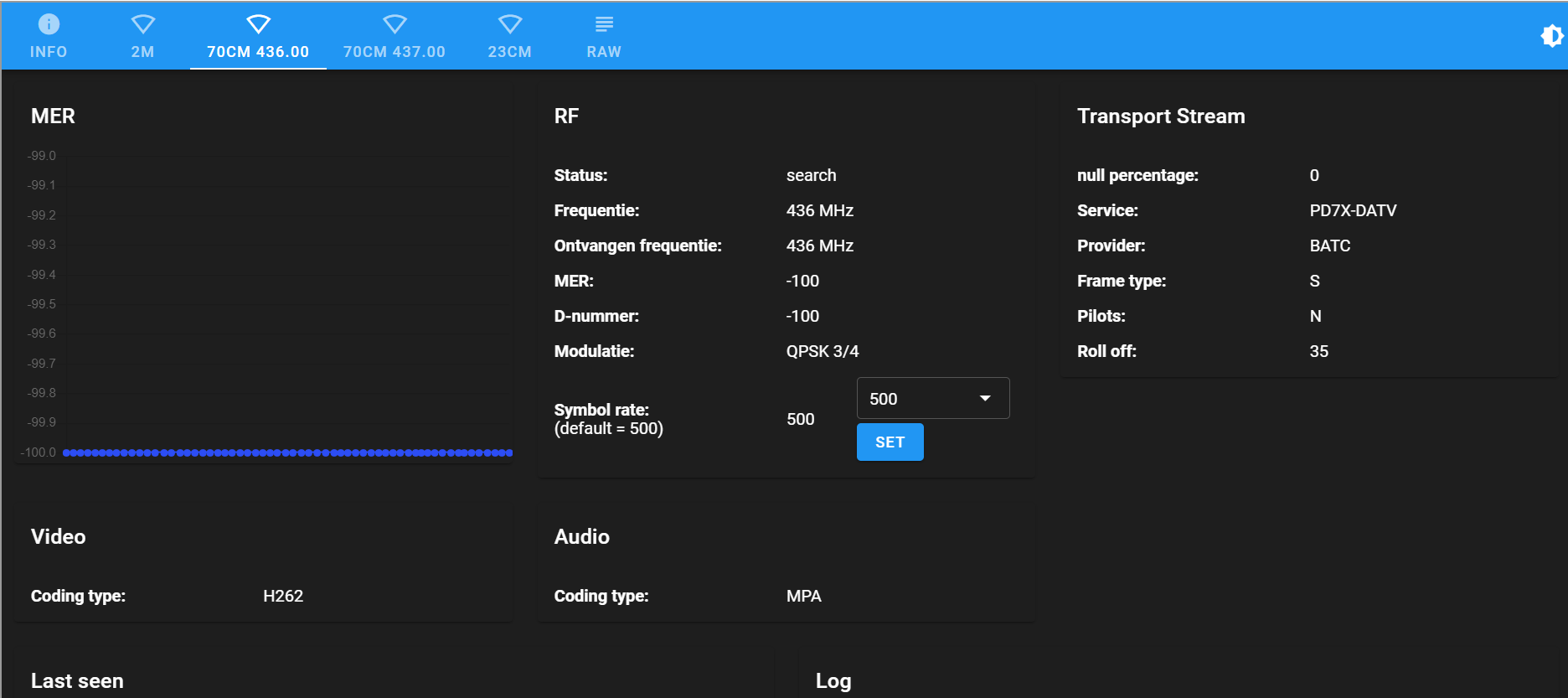

A Dutch ham build a webcontrol for the Winterhill (for repeater usage).
Users can see their reception status and can even change the symbolrate (will reset to defaults after 30 minutes).
