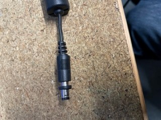

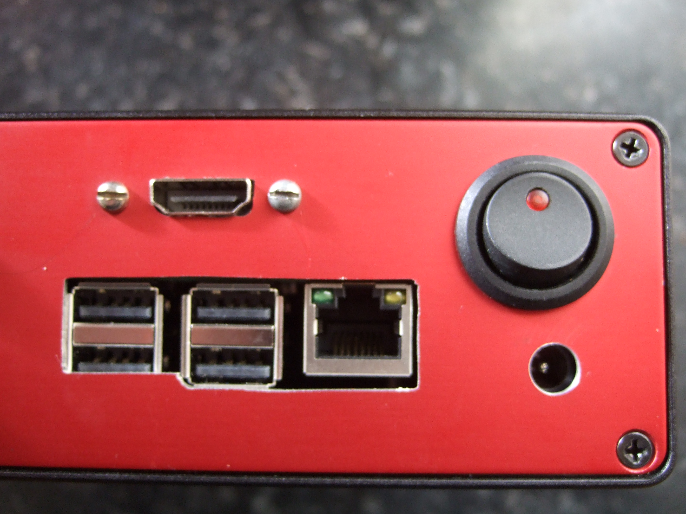

One snag is that the RJ45 and USB connector positions were swapped over on the RPi4. The connector opening on the panel would need to be enlarged slightly. Alternatively, some nuts could be fitted on the F sockets inside the case to back the pcb away from the panel. In this case, the power plug may not be able to reach the socket, but the body of the plug could have an annulus removed to give it more reach.
