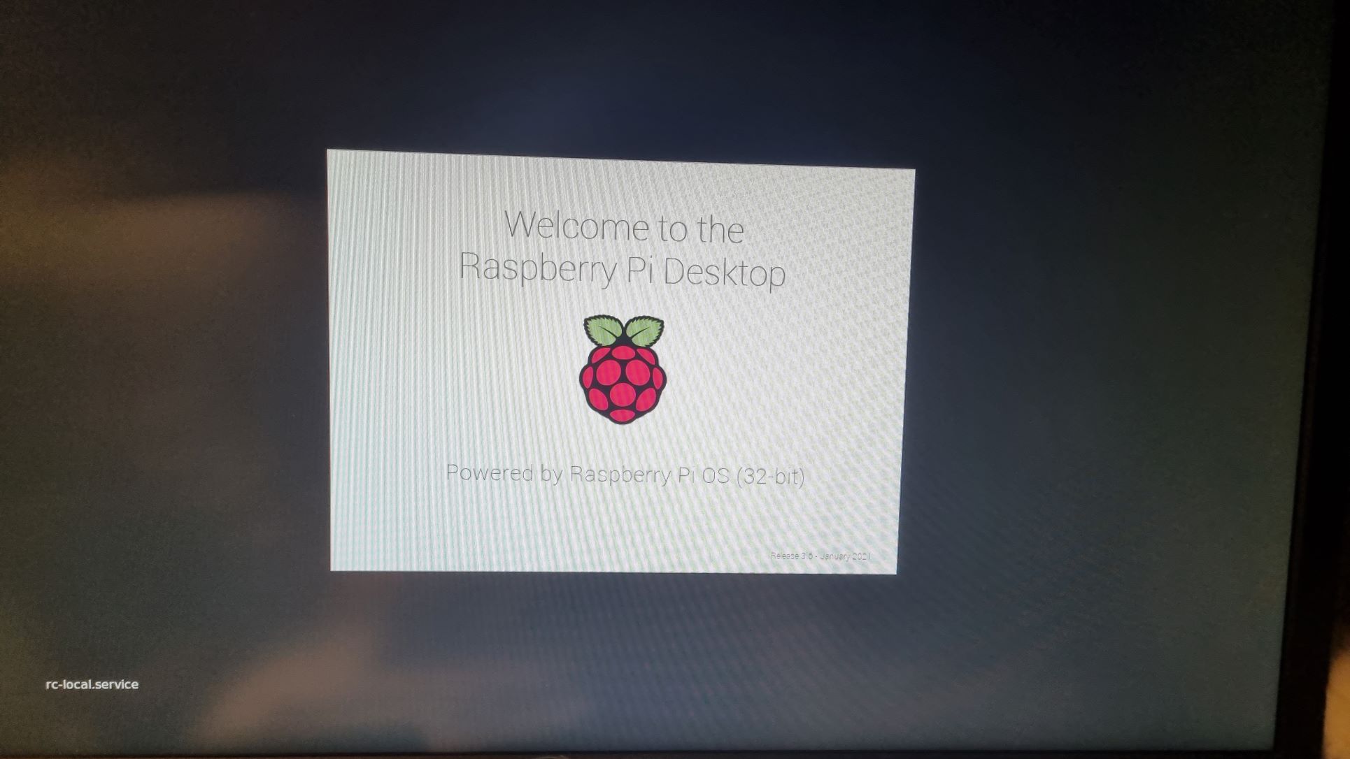

After the installation of WH via those three lines of commands the Rasperberry reboots, but I am getting always only this screen:Image
(I had to rebuild my SD as it fails after the latest RPi update...)

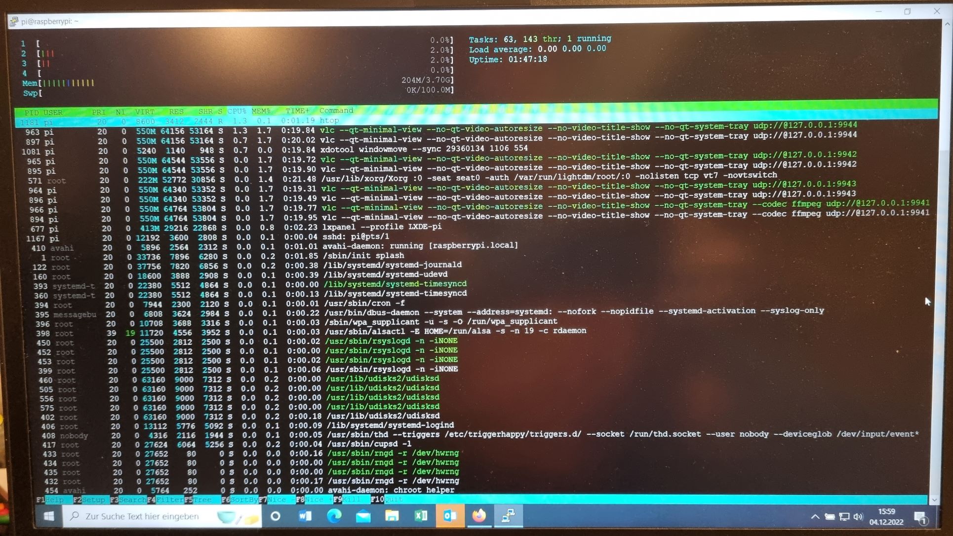

Can you ssh into it and start htop to see if any WH processes are running.
If you are using a keyboard, try this to get past the frozen screen and log in. Run htop.
https://forums.raspberrypi.com/viewtopic.php?t=246236

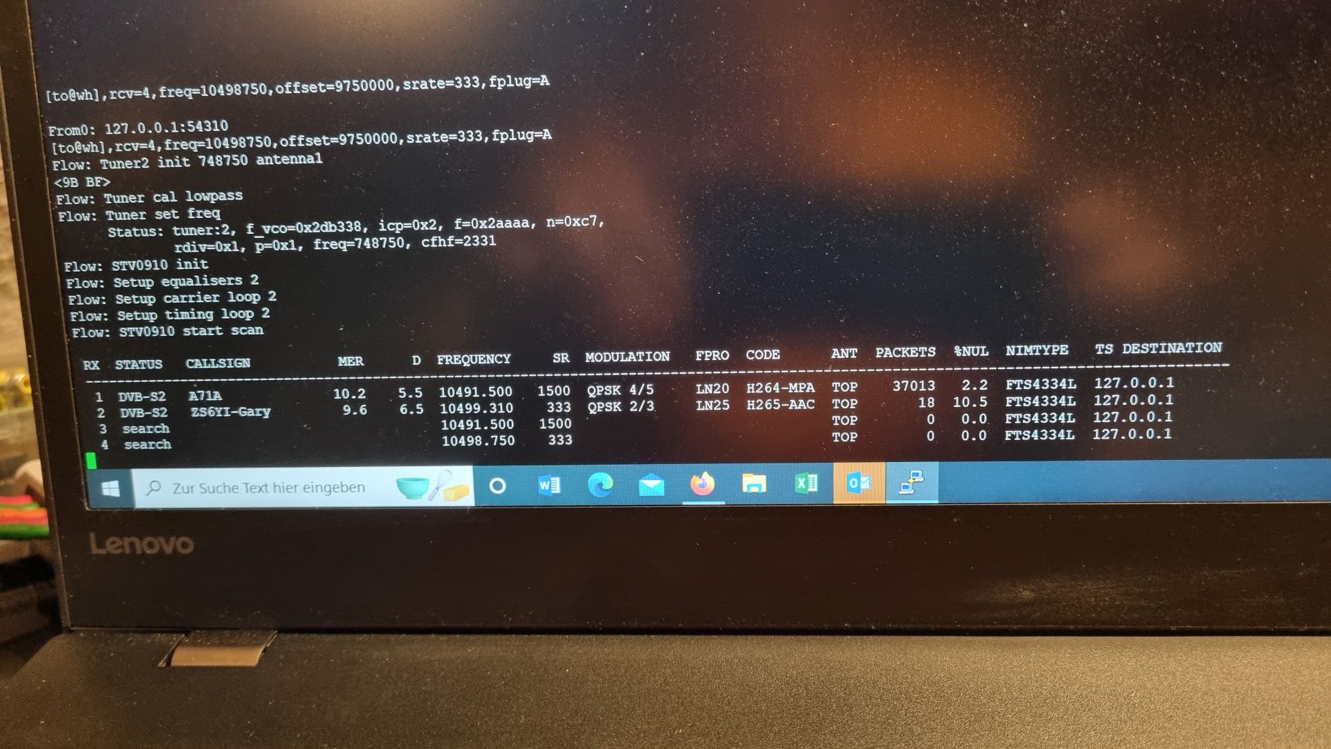

If no WH processes are running, try starting WH manually in AnyHub mode:
cd /home/pi/winterhill/RPi-3v20
sudo ./winterhill-3v20 0 9900 0 0 0 0 0
DG8KD

htop does not show anything related to WH.

After starting WH in Anyhub mode it shows the receiving of the DATV beacon.

That part seems to be working, but the beacon is not being received on RX3. Do you have an antenna connected to NIM_B?

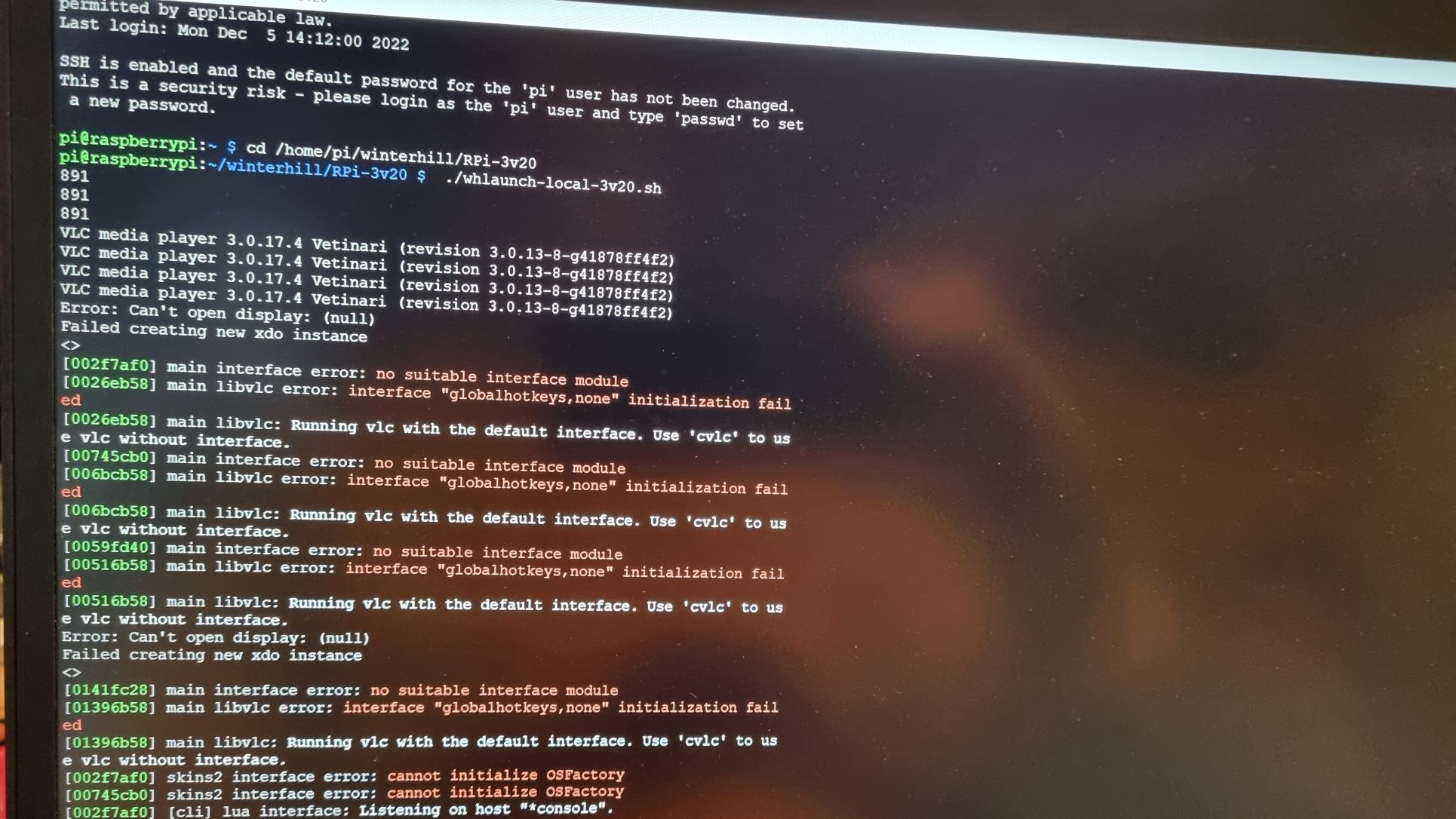

To see if the local display works, reboot and run ./whlaunch-local-3v20.sh and see if the beacon is displayed.

Local decoding is not working, comes back with errors...
Today I opened a new sealed MicroSD card and build a new card, but still the same behavior...

Were you using the attached keyboard rather than an SSH login? You need to be using the keyboard to start the launch files.
If you were using the keyboard, then it looks like you have no graphical display.

When you first boot up after making an SD card, you see the normal desktop display?
After installing WH and rebooting, it is stuck at rc-local.service?

Post by DG8KD » Mon Dec 05, 2022 6:36 pm
Code: Select all
[b]No command line, no input possible,  so only remote keyboard via ssh[/b]
Code: Select all
[b]YES[/b
Code: Select all
Surely this is the problem - using an attached screen but a remote keyboard?
