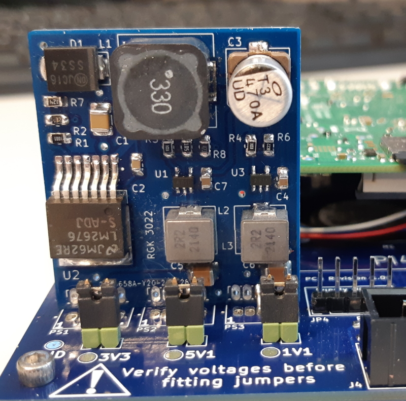

Fot those who need it:
The power modules are still hard to find, so I decided to make my own.
This module generates all 3 voltages, so only one module is needed.
(Basic SMD soldering skills are needed to assemble this pcb)
Further details can be found in the attachment
WH_SMPS.zip
design files
(169.86 KiB) Downloaded 670 times
s
success
73 PE1CHY

That's great. I was thinking of doing something similar. Mouser keep putting back the delivery dates. How are you getting 3 rails from one adjustable regulator?

Hi Mike,
The pcb has 3 regulators as you can see in the schematic diagram.
The diagram is in the attached zipfile.
The AP3418 regulators are real tiny, almost unbelievable that they "do" 1,5 amp max.
At the time of creating this design all components where available from Digi-Key, the situation may have changed meanwhile .
Another thing that helps with power problems in Winterhill, Portsdown and Ryde constructions (and all other RPi based designs)
is soldering a BIG capacitor >1000uF direct over the RPi's GPIO connector power pins 2,4 for +5V and 6 for Gnd)

The AP3418 are really quite amazing devices for their size - but be aware I found to my cost they generate a lot of RF noise so careful filtering and layout is required otherwise you may find your sensitive VHF / UHF rx's aren't quite so sensitive anymore ;-)

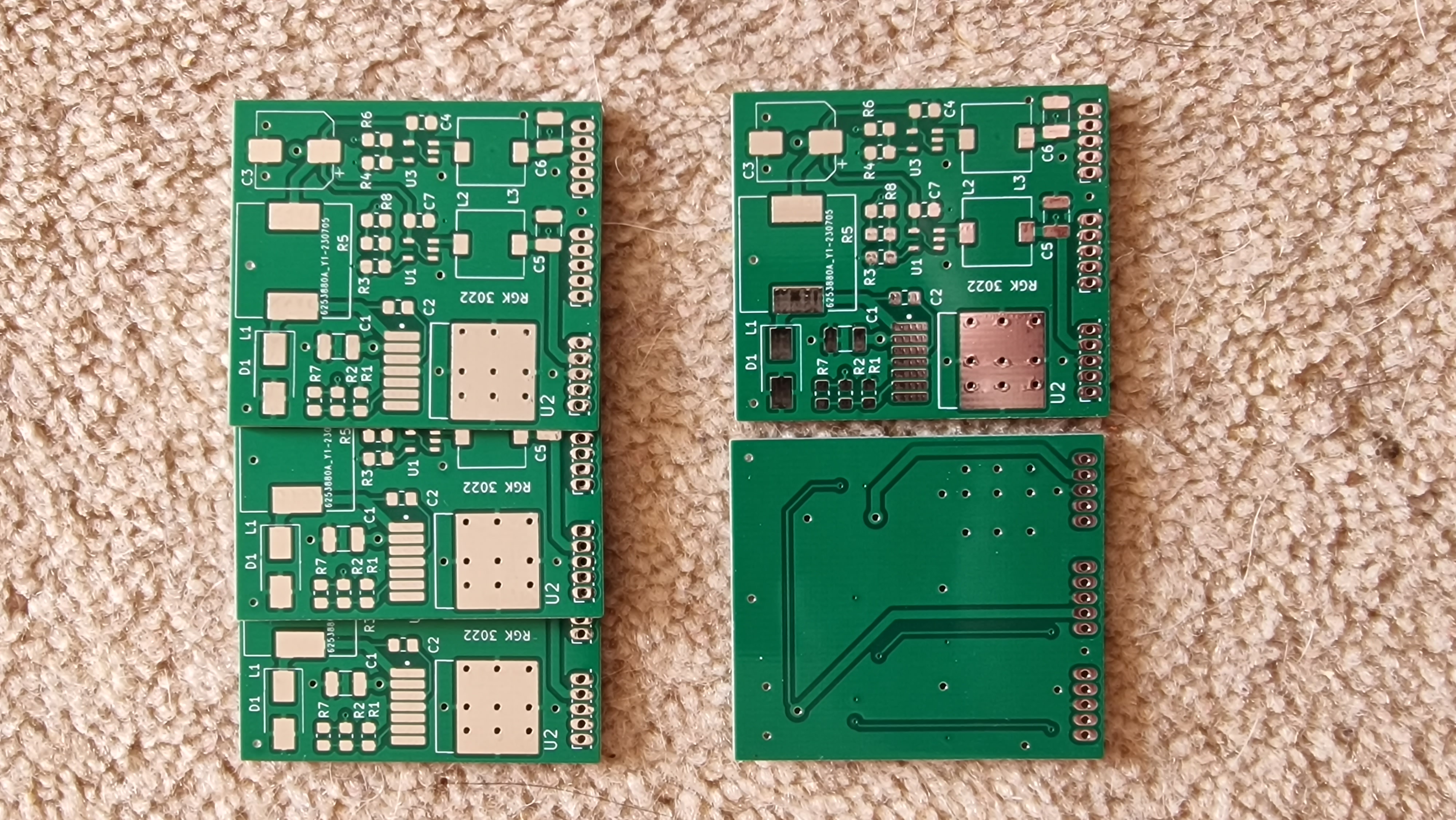

PCB's arrived just waiting on component delivery for Rob,s PE1CHY Winterhill PSU.
G6HFS
Rob PE1CHY.jpg (1.78 MiB) Viewed 13918 times

Hi Brian, (and others)
A warning, please check availability of the components before ordering pcb's.
At the time of designing this pcb all components were in production.
Now (july2323) the AP3418 is still available but declared obsolete. :cry:

Have enough parts for all PCB's, thanks for info
