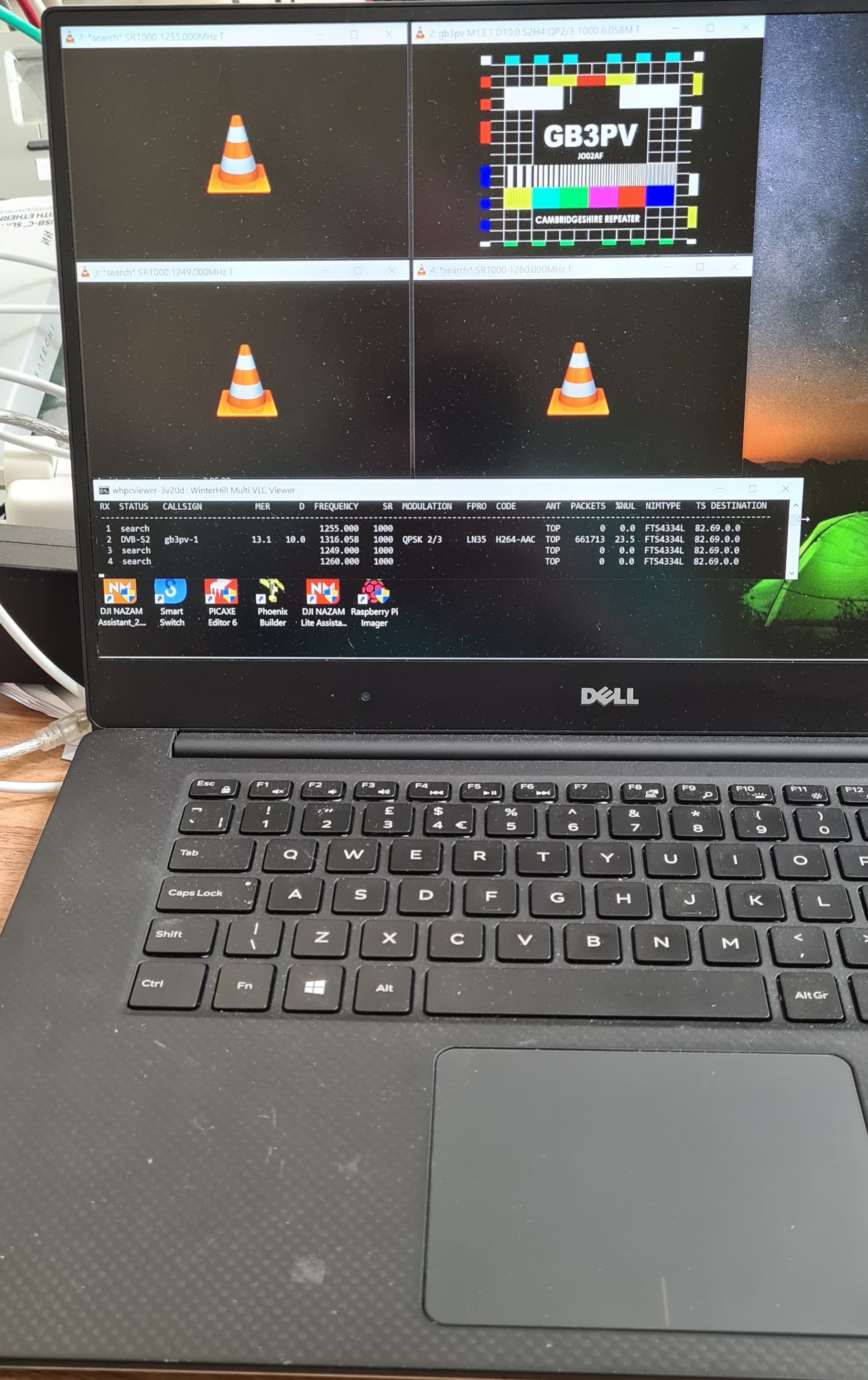

Ok, so mobile android hotspot is the problem as no port forward capability, had the chance today to test remotely today at G6EUI’s location, opened the ports and successfully sent commands and received stream.
