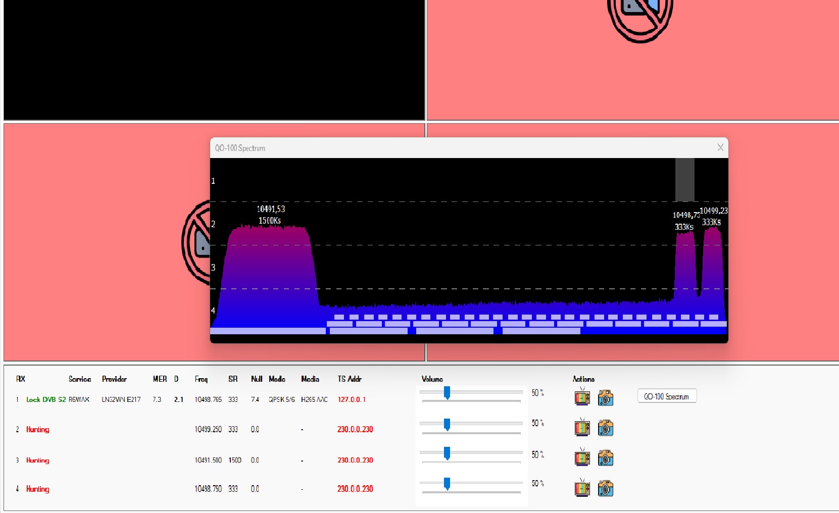

does anyone know what the small TVs under Actions mean?
The photo box makes a screen print of the received signal, but what does the other TV symbol do?
73 Thomas DL5BCA

Hi Thomas,
If you were to run in a non-fixed mode such as AnyHub, the little television icons will re-direct the output stream of that receiver to the PC on which you clicked the icon. So you could, for example, watch receivers 1 and 2 on one PC and receivers 3 and 4 on a different one. Can be quite a handy feature.
73, Martin
