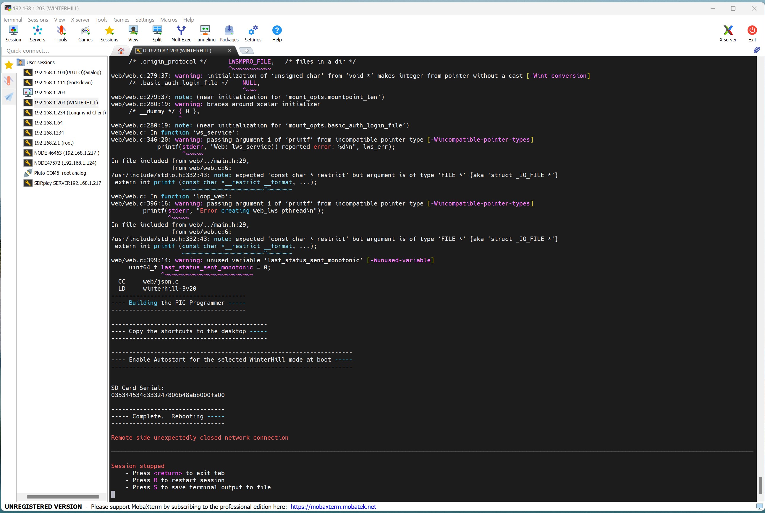

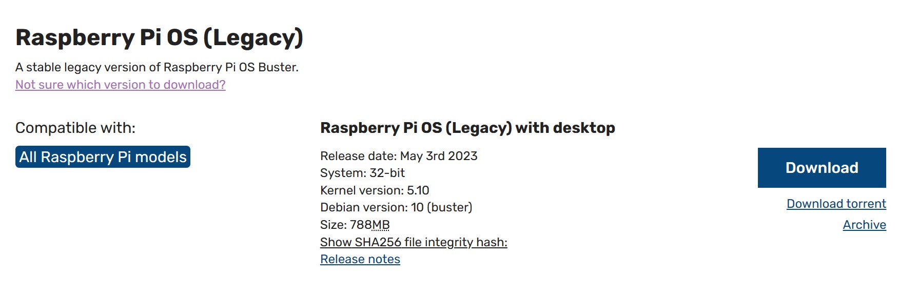

I have been trying to program a new card with Tom's WhinterHill program to try.
Had some progress but no sucsess.
I have included pictures of my progress so far.
Do I need to start again?
If so is there an idiot's guide.
I just don't get on with Raspberry Pi's.

I have just gone through setting up another SD card.
Must have missed something on my first attempts.
ALL WORKING!
Thanks to Matt for his help!
Time to play now.

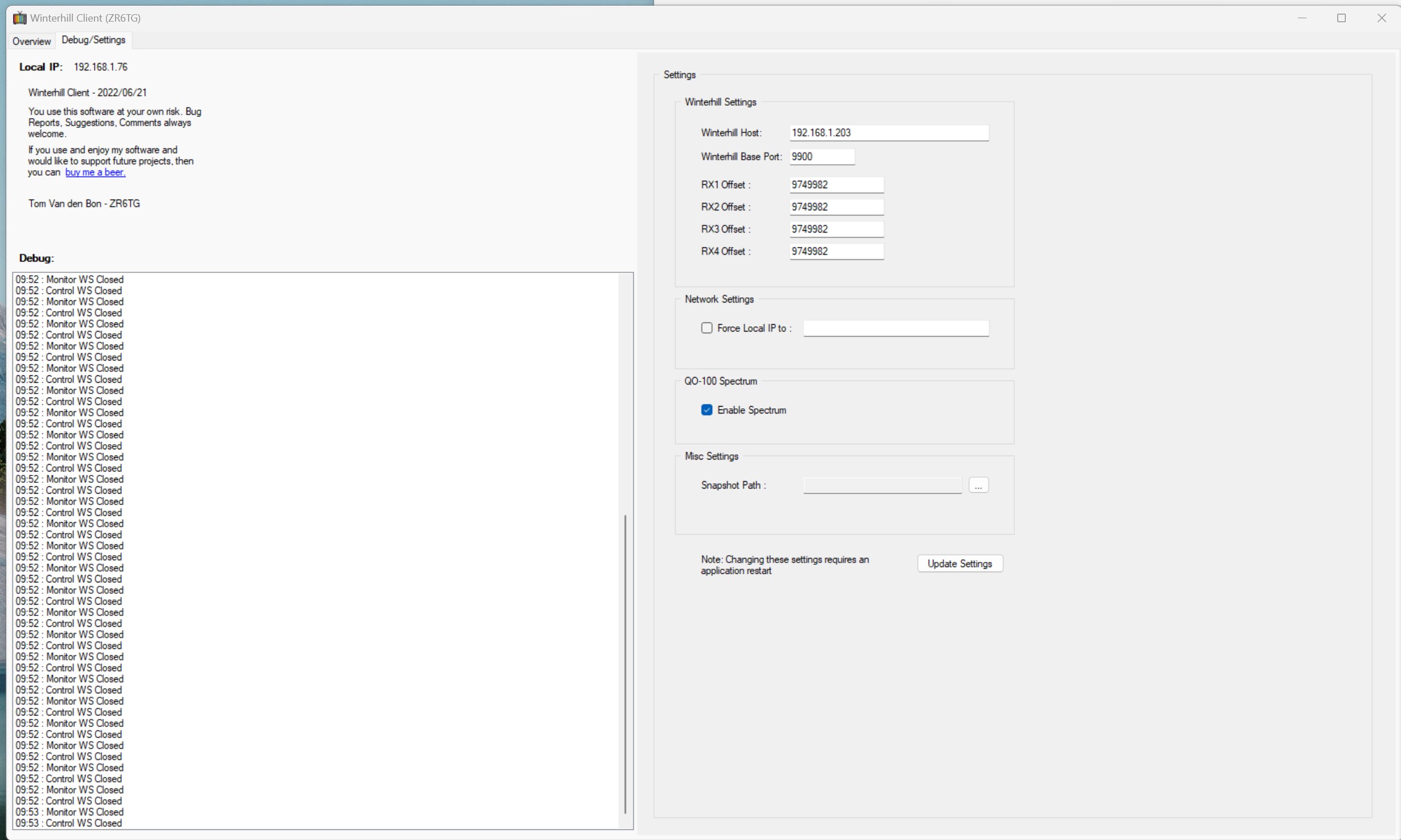

now the Winterhill receiver is running.
I have installed Tom's Client and can also call it up.
I adjusted the IP address and also entered the RX offset (all the same, since it is an LNB).
If I start on the Winterhill Local, I can use the client to control the receiver, etc. I then see the images in the VLC windows on the receiver.
On the client, the window goes black, nothing is displayed.
It's the same when I select a different mode (Anyhub, Anywhere, Fixed, Multihub). I can't get any TS data to the client.
If I interpret it correctly, the TS stream is not sent to the correct address.
Does anyone have any advice on how to set this up?

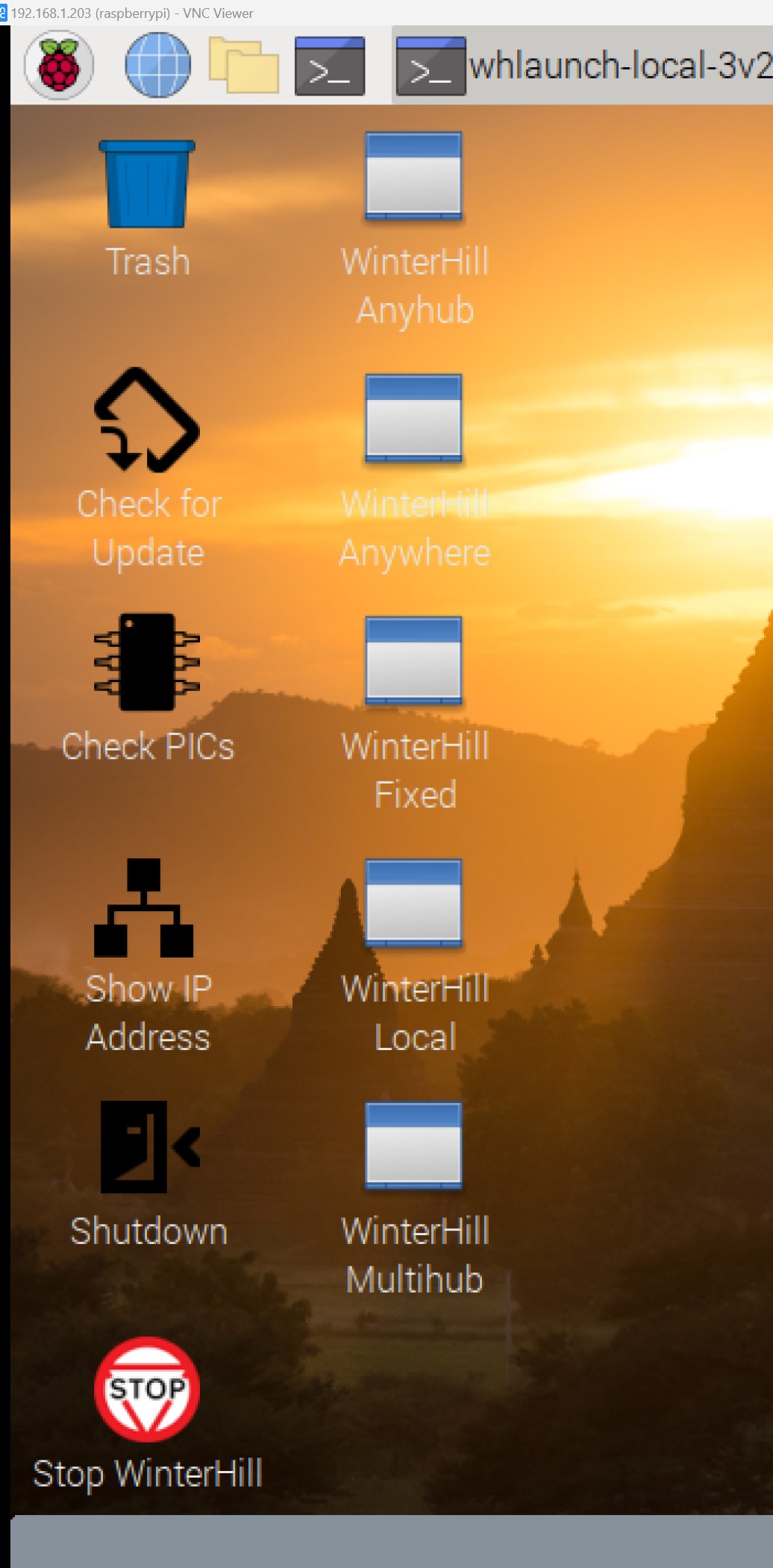

Now if you run the Winterhill headless. Is there a way to properly shut down the Raspi? I once read about a solution where you can trigger the Raspi to shut down with a button.
73 Thomas DL5BCA

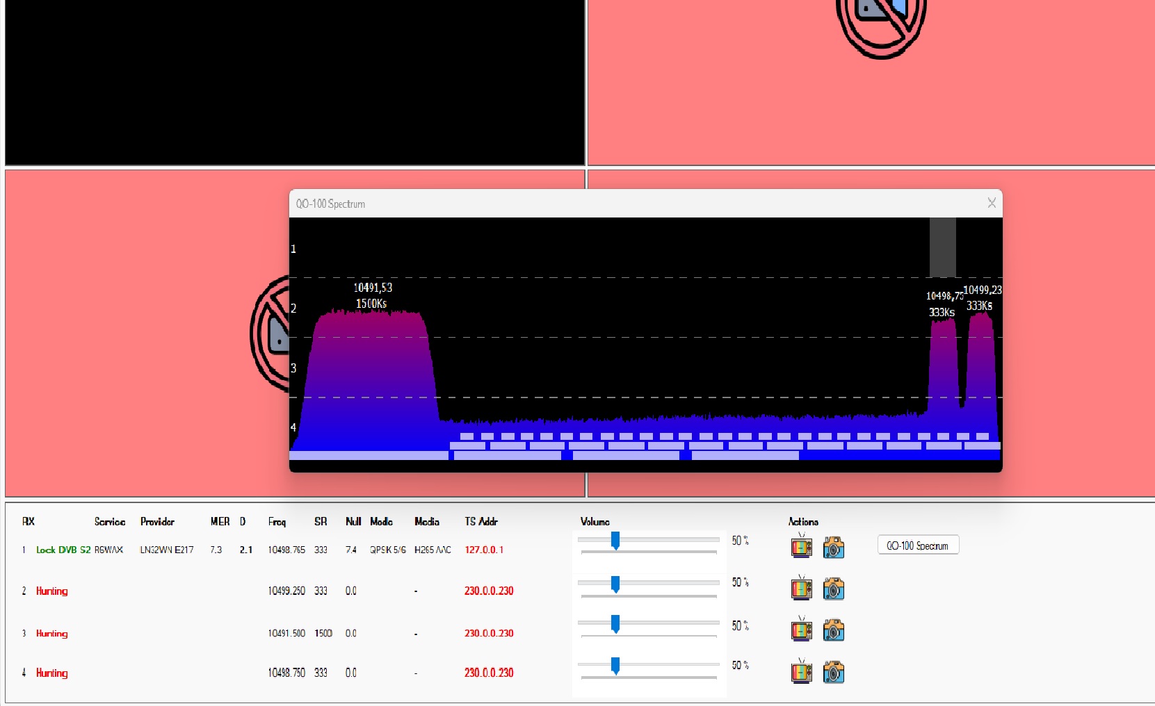

does anyone know what the small TVs under Actions mean?
The photo box makes a screen print of the received signal, but what does the other TV symbol do?
73 Thomas DL5BCA

Hi Thomas,
If you were to run in a non-fixed mode such as AnyHub, the little television icons will re-direct the output stream of that receiver to the PC on which you clicked the icon. So you could, for example, watch receivers 1 and 2 on one PC and receivers 3 and 4 on a different one. Can be quite a handy feature.
